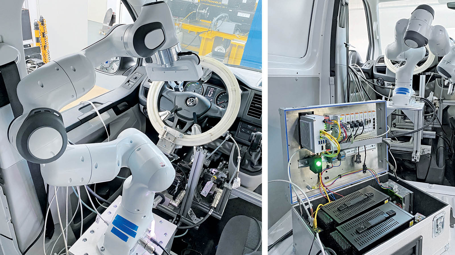

Automakers need test-bench technology that is fast, flexible and cost-effective. Researchers at Kempten University built such a test bench for ABT e-Line GmbH. It is used to evaluate the capabilities of traditional light commercial vehicles which ABT converts into electric-powered versions, in partnership with Volkswagen Commercial Vehicles.
“In the case of electric vehicles, the aim is to test whether HVAC subsystems, which draw power from the high-voltage battery, influence the vehicle’s important functions, such as switching on, switching off and driving,” says Florian Zerbes, a research assistant at Kempten. “This involves specifying a test cycle that repeatedly starts, stops and accelerates the vehicle independently over several hours or even days. During the test, test bench and vehicle data is recorded so it can be analyzed.”
During the test, output motors flanged to the vehicle wheels provide resistance to the turning wheels, which simulates driving on a road. A robot in the vehicle turns the ignition key, moves the gearshift, and operates various buttons, such as those for climate control. Linear motors press the accelerator and brake pedals, while a motor turns the steering wheel. A second robot outside the vehicle plugs and unplugs various cables from charging sockets. Sensors also record currents and voltages in the vehicle’s wiring harnesses for analysis.

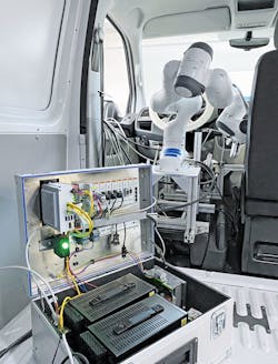

The Beckhoff control platform—a C6030 ultra-compact industrial PC with TwinCAT 3 automation software—communicates, coordinates and controls individual components and the vehicle via a CAN bus. A range of different tests, all with different procedures, can be carried out. And nine EL6751 EtherCAT Terminals serve as single-channel communication interfaces, which make it easy for the test bench to work with any CAN and CANopen devices.
During the test, the vehicle experiences real-world driving conditions. The drive test bench moves the wheels according to the simulated torques and accommodates steering movements of the front wheels. The driver’s actions are simulated by another set of corresponding actuators which are done mainly by industrial robots. The surroundings are also simulated, along with how the vehicle communicates with the environment such as using GPS. In addition to developing the test bench, the Kempten team also created a digital twin of it. This simplifies pre-commissioning the test bench.
To keep the test bench as cost-effective as possible, Kempten designers used standard industrial components such as converters, motors and controls. The test equipment also had to be quickly installed and removed from any vehicle being tested, so it had to be adaptable.

The team chose to go with Beckhoff as the central-control supplier because it offers many different interfaces for industrial components, according to Zerbes. “What’s more, the controls can be easily expanded by adding EtherCAT I/O terminals and then distributed throughout a space, thanks to the exceptional freedom of EtherCAT topology. The sheer volume of hardware and software products available means many measurement and control tasks can be completed with minimal effort,” he says. “And to top it off, Beckhoff’s PC-based control provides a cost advantage over systems from the automotive sector.”
