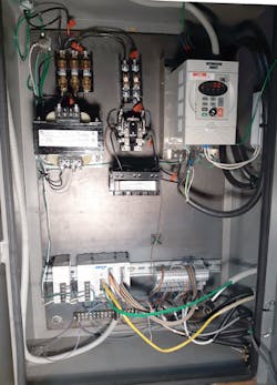

Having worked with various makes and models of PLCs, HMIs, VFDs and other automation components, I already was familiar with many of the options available from AutomationDirect. I surveyed what was needed for the project, keeping in mind this was on a personal budget, and selected the following devices, which were easily installed into a control panel:
  • CLICK Series stackable micro-brick PLC: plenty of logic capability, lots of I/O options, communication ports and free programming software.
  • C-more Micro touch panel: 6-in. color touchscreen, with five user-definable buttons and free programming software.
  • GS2 Series AC Drive: able to accept 120/240 V 1P/3P input power and generate 240 V 3P output with communications.
  • IronHorse 0.5HP 3P motor: inverter rated, and suitable for pre-mounting on the door opener.
  • Various sensors, wiring accessories such as ZIPLink pre-wired connection cables and other items.
Because the cutover from old to new controls needed to be performed quickly—so the door would remain usable—it was essential to pre-test the system as much as possible. A carefully detailed control system architecture drawing was created to show the connections, pinouts and settings of each device.
The project took advantage of serial communications between the PLC and the VFD, providing the PLC with the maximum data and control functionality possible from the motor controls. The appropriate cable was selected, but during initial testing, some lags in operation and communication errors were noticed. This was eventually solved by shielding the cable better, which is good practice any time communication cables are run near 3-phase power or inverter outputs. Another factor is that the panel is energized by a rural power grid, which can experience momentary dropouts and brownouts.

There are traditional limit switches on the door to indicate various travel positions. For the upgrade, a proximity switch and a sprocket were added to act as a simple encoder and provide pulse counts to the PLC, so the door travel distance could be tracked with an effective position repeatability of better than ±0.25 in. The pulse count is zeroed every time the door closes fully.
Control buttons and a touchscreen display are available to the user. With all these elements, it was possible to create much more advanced functionality including:
  • Automatic, manual, and jog up/down capabilities.
  • Normal close function.
  • Open to pre-determined heights of approximately 6 in. (for ventilation), 8 ft (for people and standard vehicle access) and fully open (for large equipment access).
  • Jog up or down function.
  • Accelerate from start, and decelerate to finish, for each motion to minimize mechanical wear. This also helps ensure that the door more precisely reaches the target position because it is moving slower. This single feature alone extended the mechanical lifespan of the door drive mechanism dramatically to the extent it may never need repair, but instead just routine maintenance.
  • Provisions for the system to determine where the door is located upon a reboot after a power failure.
  • Extensive diagnostics via the HMI that, such that in most cases, need no other troubleshooting tools are needed.
Both the PLC and the HMI development software were easy to use with a straightforward feature set, and AutomationDirect provided helpful support via the phone and internet to resolve a few minor hardware and software issues. For the PLC programming, a single level of nested subroutines was used to make the program organized and modular.
