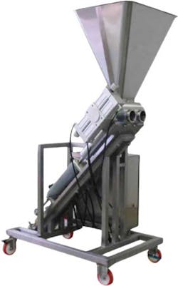

2. Design the actuator into an open-architecture system.
Stainless steel actuators let the entire machine use an open-frame architecture. This eliminates or minimizes large steel enclosures, improves cleaning and ensures regulatory agencies will likely approve the design.

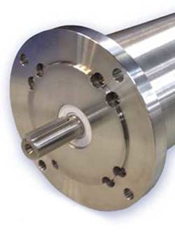

  • Those rated IP67 and painted with white epoxy. These are suitable for dry, non-contact areas rarely subjected to washdowns. Their environmental sealing, epoxy paint and nickel-plated connectors do not stand up well to common cleaning agents applied with high-pressure sprayers. The epoxy paint can flake off, cleaning fluids can enter through shaft seals and nickel-plated connectors discolor from oxidation.
  • Those rated IP69K and made of stainless steel. Motors that carry the IP69K rating are ideal where hygiene and cleanliness are critical, as they are proven to be durable and resist water, chemicals, high pressure and high temperatures associated with demanding cleaning and safety measures.

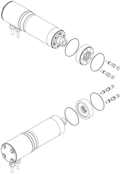

Flanges available on hygienic motors include the XXX C-Type flange (Rockwell VPH shown), which is easier to seal and clean, reduces areas for harborage and should include an FDA compliant O-ring. Before choosing a C-type flange motor, make sure the motor supplier provides an O-ring (some motor suppliers force the user to source the O-ring separately).
Another option is the XXX D-Type flange (Elwood W-Series shown), which is difficult to seal and clean. It frequently does not provide O-rings or gaskets and just suggests using RTV to seal the motor-to-actuator interface.
