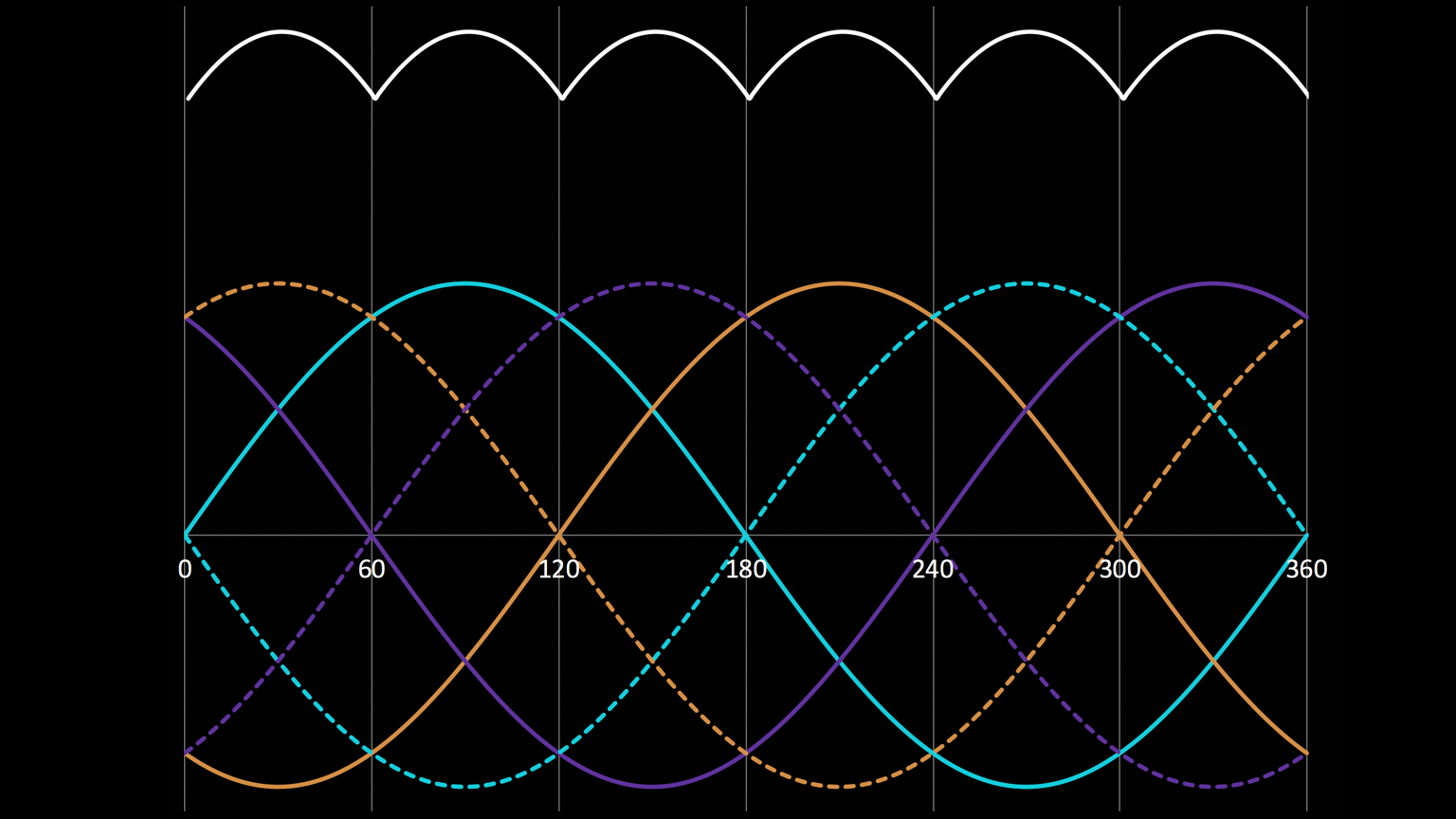

Sensorless commutation. This method does not require sensors to know the rotor position. There are different techniques of determining the motor’s rotor position without using sensors. The most common is to sense the back EMF (electro motive force) voltage of the non-energized phase of star connected windings. This requires a minimum speed to generate enough voltage, as the back EMF is proportional to motor speed. The back EMF of a motor at stand still is zero. Generally, an open-loop driving sequence starts the motor. Therefore, this type of drive method is not recommended when a motor must operate at stall conditions.
Six-step commutation. Consider a typical brushless DC motor with three phases and one pole pair, which is the easiest case to understand. Such motors can have three Hall sensors shifted by 120 electrical degrees to detect rotor position.
The Hall sensors generate high or low output signals depending on the rotor flux’s direction. Therefore, it generates a six-step logical commutation table over 360 electrical degrees, which is equal to one motor rotation for a one-pole pair motor. Then, the driver energizes the right phases to keep the angle between the stator  and rotor fluxes close to 90 deg. to maximize the torque generated. The graph below shows the typical shape of a phase current in each logical state of the three Hall sensors.
This is a discreet six-step commutation, so the torque will not be constant and will be subject to ripple. The graph below shows the shape of the back EMF (BEMF) over 360 deg. and BEMF’s derived shape. The output torque of the motor would have the same shape.
The available torque will be lower at the moment of theoretical commutation and at its peak (between two commutations). This depends on the angle between the rotor and stator flux (over one-sixth of the entire revolution). This difference between the top and bottom of this ripple is 13.4% of the torque available.
