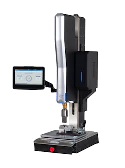

Emerson’s Branson GSX-E1 ultrasonic welder

To ensure operational quality and success as well as the availability of secure, high-integrity manufacturing data from one important piece of many manufacturing processes, Emerson’s software development team took a look at the security needs of automated ultrasonic welding systems. Ultrasonic welding systems play a major role in the manufacturing of a wide range of medical, electronic, automotive and consumer products and are vital to the production of personal protective equipment and a wide range of packaging for foods, beverages, snacks and other products.

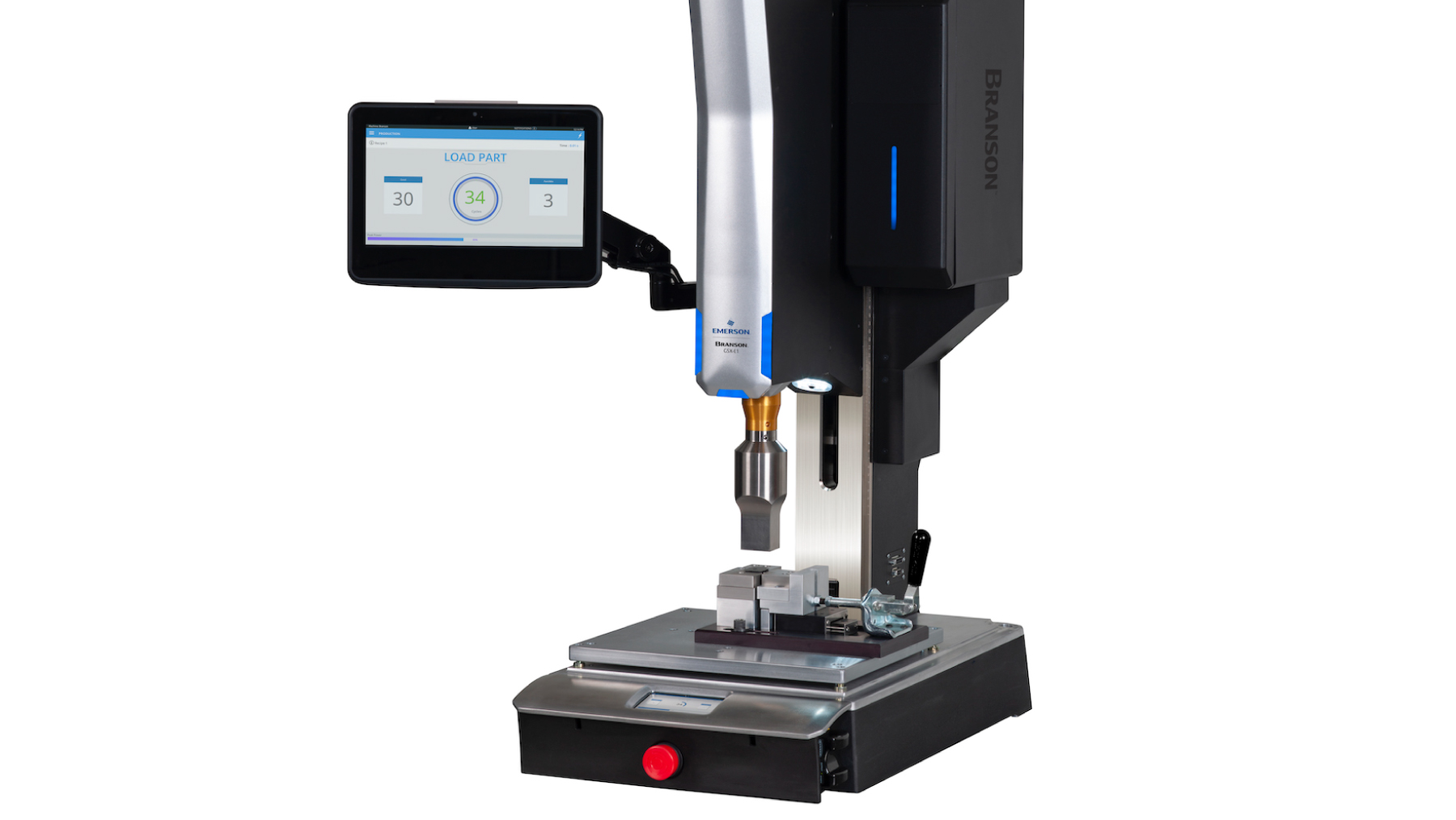

To ensure that its newest ultrasonic welding platform, the Branson GSX-E1, would not only meet the stringent FDA data-integrity requirements but also deliver the high quality and volume of secure production data demanded by other manufacturers, Emerson determined that this welding platform would be upgraded to provide security features modeled on those of typical “front-line” IT equipment—computers and servers connected directly to the internet.
Through these software upgrades, the welding platform is capable of supporting 21 CFR Part 11 standards for data integrity, which include validating users for system security, storing data for up to 200,000 individual product welds, creating audit trails capable of identifying data manipulation and delivering data to meet FDA traceability requirements. The platform is also capable of meeting the most stringent demands of high-value, high-volume manufacturing processes worldwide.
A second and related upgrade to the ultrasonic welding platform gives it market-leading encryption technology that ensures the integrity and security of data transfers. After authenticating the identity of the data recipient, this technology assures secure data transfers from welders on the manufacturing floor to local or remote enterprise quality management systems, to customer systems or to regulatory bodies. The authentication process ensures that the data is coming from a reliable source (the welder) and that the welder is not sending data to an unidentified fraudulent attacker.
