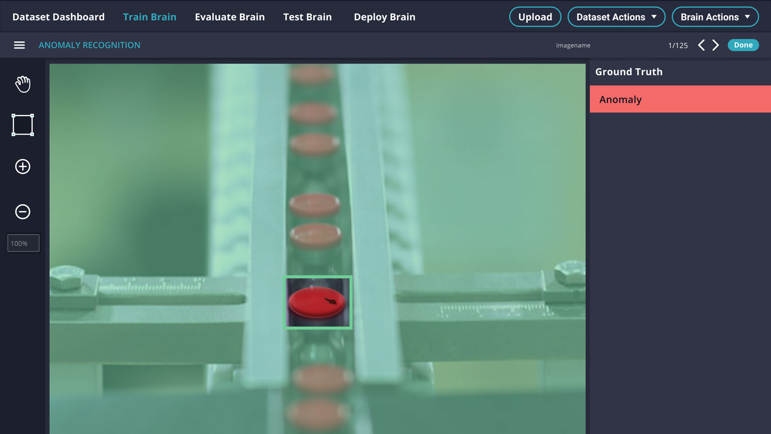

For vision AI software company Neurala, Inc., the launching point for manufacturers may very well be at the site of the product line. The Boston-based company recently introduced its VIA (vision inspection automation) software, which enables manufacturers that have not worked with AI before to train and use vision AI to identify defects in products or packaging on the production line.
The anomaly recognition technology identifies products that deviate from “acceptable” images without collecting images of defective parts. The system builds on Neurala’s Brain Builder platform that allows quality control managers and vision specialists to deploy vision AI for inspection and allows manufacturing plants to integrate legacy hardware on the floor.
