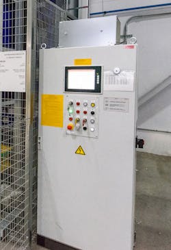

When it comes to industrial electrical safety, the best offense can be a good defense. In other words, if there were a way to keep people away from dangerous electrical equipment, it would lower the chances of anyone getting hurt. One simple way to do this is to keep risky equipment secure in an enclosure. Enclosures prevent injuries, along with inadvertent tampering and vandalism.
Most automated and factory equipment requires electrical enclosures, sometimes called control enclosures. They keep moisture, dust and contaminants away from electrical and automation components. They also keep workers from getting too close to electrical components. Enclosures are best located so they do not impede traffic and aren’t in crowded areas.
Eventually, someone will need to get inside the enclosure. That could be maintenance technicians making annual checks and upgrades or inspectors looking things over. So, inside the enclosure, engineers should choose components and assemblies with guards, shields and other devices to stop visitors from touching energized components. Components should be laid out so there’s enough working room and adequate airflow. Wires should be neatly routed using wire ducts so that wires and workers are protected.

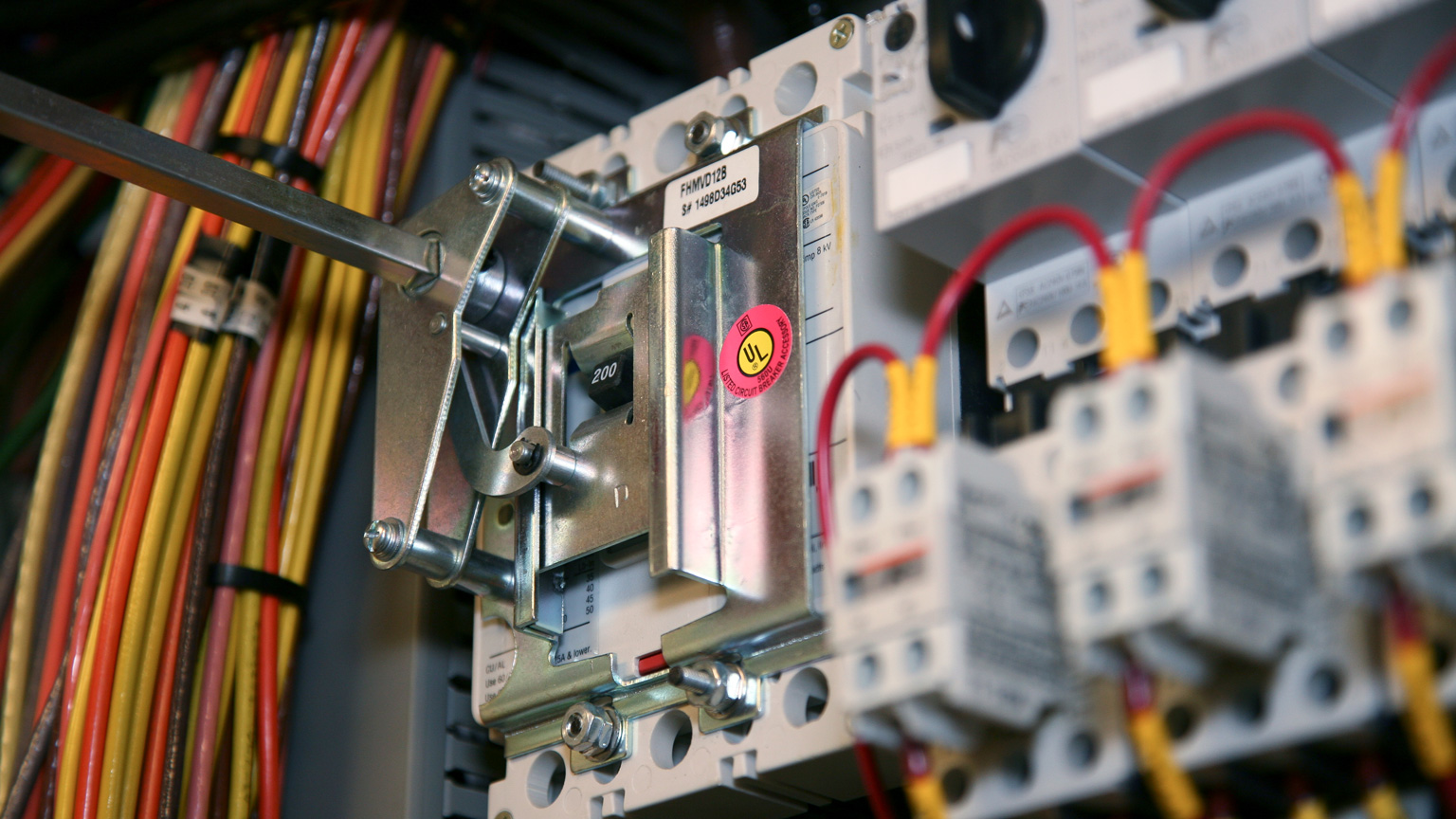

The electrical design inside enclosures should also be safe in terms of power distribution and control circuitry. It must follow NFPA 70 National Electrical Code (NEC), which is the benchmark for safe electrical design and installation practices to protect people and property from electrical hazards. Provision and sizing of disconnect switches, overcurrent devices, conductors and associated components are all covered by the NEC.
Disconnect switches are primary electrical safety devices that isolate downstream electrical systems from upstream power. They are used in electrical switchgear, panelboards and control panels, as well as for mounting close to power-using machines such as motors. Disconnect switches can be locked open by users to ensure downstream equipment is electrically safe for maintenance or repair.
In power distribution and control panels, overcurrent devices such as circuit breakers fuses, and motor overload devices, protect downstream conductors by automatically opening a circuit when there’s an overcurrent or short-circuit. This protects equipment and workers from fault conditions.
