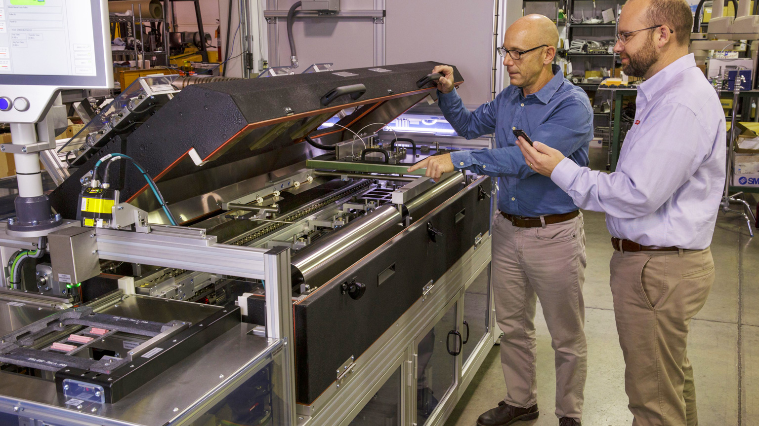

When a tier-one automotive supplier, a long-time customer of Pensar Otra Vez, needed a new printed-circuit board (PCB) handler, project manager Mike Edwards automatically went back to the drawing board rather than copying the existing design. This way the handler would have leading-edge technology and capabilities.
More than 20 Pensar-built handlers were already working at one of the customer’s Texas plants, so there was a clear baseline to measure improvements against.
The handlers receive incoming PCBs at room temperature, elevate them to approximately 110°C and hold that temperature within ±3° during a test that simulates operating conditions in a vehicle. The test takes less than 120 sec., so the handler must quickly heat the PCB. The PCB goes through four preheat stops while IR sensors monitor temperature rise. On the previous generation of handlers, this created a wiring challenge with significant costs for labor and cables. Throughput is most important, so the handler must also maximize testing, not handling time.
The goal of the redesign was to increase performance and lower component costs as the handler followed the same testing processes. In addition, the company wanted to update the HMIs for easier operation and maintenance. Finally, the user wanted the handlers to have better data acquisition and analytics capabilities as a path toward IIoT and Industry 4.0. This automotive vendor has plants around the world with plans for widely measuring processes and enhancing efficiencies.
Pensar had a few other goals in mind as well. They wanted the machine to use less cabling, be smaller and be easier to use.

The TwinCAT program is loaded on a C6030 ultra-compact industrial PC from Beckhoff that boasts a seventh-generation Intel Core i3 processor with two cores and a 3.9-GHz clock speed. To improve the operator interface, the handler features a CP3921 multi-touch control panel with custom push-button extension, and a 21.5-in. (1,920 × 1,080) display. “Not only are the new Beckhoff touchscreen displays enclosed in very sleek aluminum enclosures,” says Edwards, “we can also add the e-stop and other switches in the bezel below the touchscreen. This simplifies wiring, and it groups essential operator inputs in a way that makes sense.”

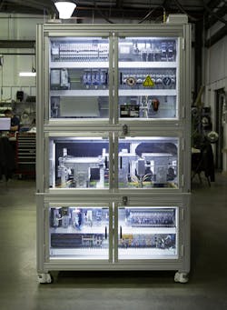

The choice of network topologies, using one-cable automation (OCA) via the EtherCAT P standard, and eliminating switches all helped shrink the machine’s footprint and complexity of its wiring. The handler uses a mix of IP20-rated I/O terminals, IP67-rated box modules and OCA devices to provide communication and power for field devices in a single cable.
“EtherCAT P and machine-mounted I/O components let us run just a single cable back to the main control cabinet,” notes Edwards. “In addition, using Beckhoff components in the control panel eliminated even more wiring and basic terminal blocks, and reduced panel space needs and wiring time to sensors and motion control components in the field.”
To carry the PCBs through the test stations, the handler operates a conveyor powered by IP54-rated AS2022 stepper motors with torsion-proof encoders built in, paired with AG2250 7-to-1 gearboxes. DIN rail-mounted EL7047 stepper-motor terminals power the two-phase stepper motors, delivering 8 to 48 V dc at 5 A via a one-cable connection.
The previous design used a motor and gearbox on each side of an edge-belt conveyor. The motor speed was displayed as a numerical analog number that wasn’t motor rpm or belt fpm. The new Beckhoff drive easily displays true motor rpm, so both conveyor sides can be accurately monitored and adjusted. This also provides greater control and data acquisition compared to the previous machine design
The redesigned handler cost 9% less than the previous versions, it used 11% less labor to wire it and the electrical cabinet is almost 13% smaller due to fewer number of terminal blocks needed. The overall system was also easier to debug; the team knocked 36 hours off the design time for the controls.
The redesigned handler has been operating in the field without issue, and the Pensar Otra Vez team would like to retrofit the others with the new architecture eventually.
