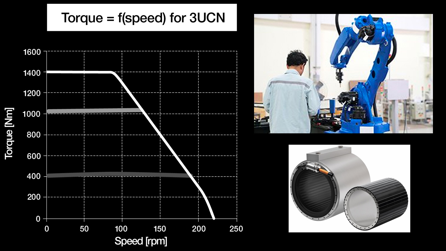

Understanding the needs and selecting the best servo motor for an application is often called motor sizing. That’s because the relationships between speed and torque and the application’s needs determine the size of the motor and its relative force density. To calculate these, engineers must know the payload’s weight, the distance and time of the cycle’s movements, along with the rest/cooling in between; this is also known as the duty cycle. Rather than use distance with and time, distance with speed and acceleration can be used. The goal is to determine how long the payload is accelerating so that torque can be calculated.
Once the application is specified, identifying the peak torque, continuous torque and speed required narrows the search for the right motor. Torque and speed go hand-in-hand when selecting a servo motor.  To better understand the relationships between the two in a specific application, engineers rely on torque curves. They graphically show the relative torque and speed needed and whether they will be needed continuously or intermittently.
Rated torque and rated speed are useful terms regarding the application’s torque and torque curve. Rated torque is the maximum torque a motor can produce continuously and rated speed is the top speed at which rated torque is available.
Continuous torque, also known as root mean square (RMS) torque, is a time-weighted average of torque during a complete cycle. It must fall within the torque curve’s continuous region to be able to maintain the required speed.
Peak torque is the maximum torque needed at any point during the cycle. Ideally, peak torque is in the torque curve’s intermittent region because it cannot be constantly maintained. If an application’s peak torque falls in the motor’s continuous region, then the motor is probably too big.
Speed, usually measured in rpm, is just as important as the payload’s weight when selecting a servo motor. Generally speaking, the higher the motor’s speed, the lower the possible torque. Low pole counts deliver higher speeds and lower torques because of several factors, including back EMF.
