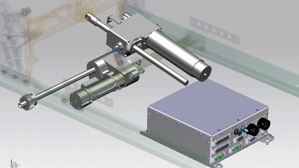

The image 3D rendering of the design shown here illustrates the quiet-operating SkyMotion seat actuation system under a premier-class seat. Included are the master control unit as well as brushless dc motors and actuators in the background.
ITT Enivate’s new SkyMotion power seat actuation system, which includes all the devices that control the motion of premium-class seats, is quieter than other designs. It consists of rotary and linear actuators in a range of output forces, a master control unit with integral power supply, a pneumatic high-flow lumbar system with active deflation, and a positive lock.
The latter replaces friction brakes and addresses airline industry guideline ARP 5526C without external latches. What’s more, the overall actuation system is 10% lighter weight and up to 5 dBA quieter than prior designs. The SkyMotion system also includes auto-calibrated actuators that mechanics can replace in minutes:
