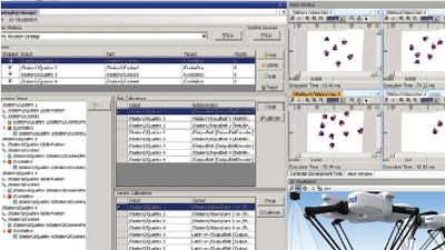

A packaging line that conveys thousands of product pieces per minute requires several robots to handle that kind of volume. Designers must decide how many robots are needed, and what pick rates should be used to maximize transfer efficiency. This is called line balancing. Application software can help designers here.
Bird's-eye view: Above, PackXpert runs on a PC to manage a vision-guided, conveyor-tracking pick-and-place robot. Within a couple hours, a designer can calibrate vision, robot, and belt, and build a logic sequence to set the robot to use vision to locate parts, synchronize with the belt, pick up parts, and package them. The software simplifies the process, turning programming (AKA writing software, what it used to take to implement a robot) into configuring software. For more information, visit www.adept.com.
