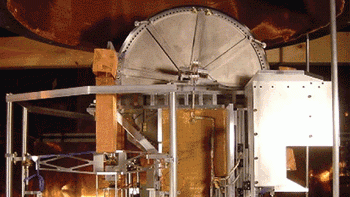

The most significant change involves the kilogram, the only one of the SI's seven base units still defined in terms of a material “artifact” — a 130-year-old platinum-iridium cylinder maintained at the International Bureau of Weights and Measures in France. The kilogram artifact poses long-term problems because its mass changes slightly over time. In the current SI, it's not just the unit of mass that depends on the kilogram: Definitions of the ampere, mole, and candela ultimately depend on the platinum-iridium artifact. For example, a mole is currently defined as the number of carbon-12 atoms for which total mass is 12 grams.
With the new proposal, the kilogram is defined in terms of the Planck constant h, an important constant in quantum physics, which is expressed in units containing the kilogram. Efforts at NIST such as the watt balance experiment and determinations of the mass of one mole of silicon atoms offer new ways of determining an accurate value of h, thereby contributing to a more reliable definition of the kilogram.
