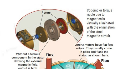

That's why some motors use Lorenz forces instead. Named after the Nobel laureate, this force is that experienced by a point charge moving along a wire in a magnetic field, at right angles to both the current and magnetic vector. Current in a Lorenz motor may be viewed as a procession of moving charges subject to Lorentz force, thereby transduced to a force on the conductor itself. This force is then multiplied by the number of coil conductors.
Note: Versions of Lorenz-force motors are sometimes also called pancake motors; Timken has used them in cutting-edge vehicle designs detailed here.

In short, Lorentz and Faraday motors both use electromagnetic properties to create mechanical work, but the way the forces are applied in a traditional Faraday motor means it is always trying to reshape itself. By contrast, the lack of steel in Lorentz-force motors allows application of electromagnetic forces with almost no mechanical energy losses — and no electrical lamination “buzzing” noise.

A: It's been held that power density is not achieved by coils alone. However, the forming, interleaving, precision layer winding, and square magnet (or litz) wire in Lorenz stators eliminates the need for steel poles to concentrate flux created by current in the coil. Stacking of coil and rotor segments multiplies torque in a compact package, and extra multiplication is possible with integral planetary gearheads — in virtually the same footprint as an induction motor.

A: Eliminating poles to concentrate flux means the motors effectively eliminate core saturation, without exotic steels. No saturation means a linear current/torque relationship over an unusually wide range resulting in high torque at low rpm, including at stall. This allows the use of high current to produce proportionally high torque, for better efficiency and less waste heat. Together, extended torque linearity and higher torque translate into excellent damping and reduced overshoot in servo applications. (Because the controller doesn't have to compensate for saturation or iron losses, it gets back everything it puts in.) Performance is consistent in all modes: constant or variable speed, steady state, intermittent, and reversible.
