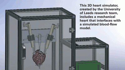

In short, HIL simulates some components with software, and links these to physical pieces of hardware from the same system. For the heart simulator, a mechanical heart functions as hardware within a simulated blood-flow model loop. Then the continuous feedback loop between them is used to assess how the iVAD device's physical assistance affects the heart and blood flow if implanted inside the body.
The mechanical heart's shape is defined by two modifiable semicircular patterns of buckled spring steel strips, which are attached at both ends with adjustable boundary conditions. A custom-built NI vision program helps define the necessary boundary conditions to match the profile of each steel strip to a reference heart model. Two linear actuators cyclically flex the steel strips and realistically represent the dynamic movement of the heart's right and left ventricles. Actuator motion within the blood-flow model is controlled to mimic the simulated heart, so that the physical heart immediately reflects any volume change to the simulated heart.
In addition to matching the heart shape, the arrangement allows local variation of stiffness around the circumference of the mechanical heart by individually altering the mechanical properties of the strips, such as thickness. A thin elastic skin is used to surround the strips and apply the iVAD.
