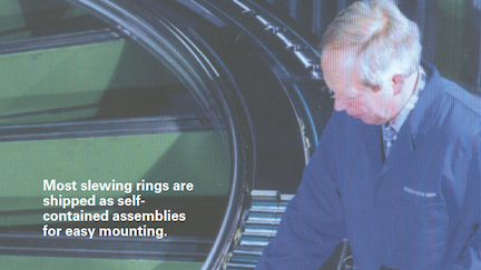

Bolt it in place, and off you go: A slewing ring is a contained system of balls or rollers, caging, raceways, mounting.
Bolt it in place, and off you go: A slewing ring is a contained system of balls or rollers, caging, raceways, mounting provisions, and often, integral gearing as well. These large units are designed to transmit axial, radial, and tilting moment loads. And because they handle loads (and different combinations of them) in one assembly, these bearings eliminate weight, space, and cost penalties of other rotational designs.
