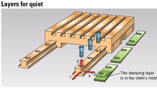

Shims make connections tight to reduce play and resulting vibration. Laminated shims, manufactured from metal or composites that peel off in strips a few hundredths of a millimeter thick make for well-coupled monolithic gap compensation.

One shimming option is ground shims: With these, a technician determines how much compensation is needed and grinds spacers with a machine — a time-consuming process. Another option is solid shims: A technician inserts stacks of thin plates into areas with play — a setup that can collect grease and dust.

Layers for quiet
Laminated shims are made of thin sheets that can be peeled off to adjust thickness. Some varieties are embedded with electronic identifier chips that can report design specifications to handheld readers.
