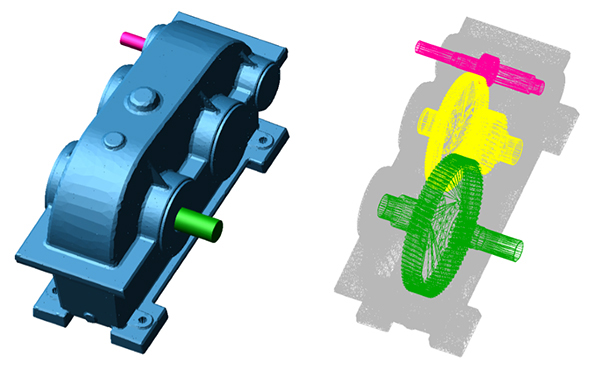

Consider a gearbox composed by three gear pairs. The input wheel is subject to a rotation ranging between 0 and 3000 RPMs. To evaluate the acoustic response we can consider a number of microphones distributed around the gearbox. For example, the microphones could be spatially distributed accordingly to the standard ISO 3744.
3. Gearbox model with three gear pairs and flexible casing.
In the MBD model, the gearbox casing is considered flexible to capture its surface response. The rest of the gearbox (i.e., gears, shafts, bearings) are rigid parts. Although the gears are not flexible parts, it is still possible to calculate the tip relief and crowning effects which can impact the dynamic loading on the gearbox casing.
