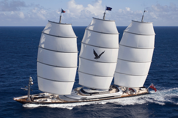

The Maltese Falcon a luxury sailing yacht measures 289ft long with a 41ft beam and x 20ft of draft The design of the sailing rig for this vessel will most likely be studied and improved on for many years to come

The use of modern materials and design techniques to update earlier concepts is a major driver in the revival of commercial sail. For example, one design breakthrough was the combination of rotating carbon-fiber masts and practically robotic sails. They were both used on the steel-hulled Maltese Falcon, a ship built in 2006 that can be sailed by a single person. The sails and masts on this full-rigged yacht follow the Dynaship concept invented in the 1960's by German hydraulic engineer Wilhelm Pröiss.
This sailing rig is also the same general concept used in the Ecoliner and for our proposed ship’s three masts. But we combined it with a centuries-old idea developed by the Polynesians: the tripod mast. Carbon-fiber masts that rotate would be too costly for a commercial vessel. And unloading containers near large rotating masts would expose delicate mechanisms to damage.
The tripod mast we propose (see Tripod Mast Concept) spreads loads across a wider area of the hull and deck and lets it be made of conventional steel. It also moves the rotating machinery for the sails up and away from container-handling areas while still letting the sails rotate 180°, from full port to full starboard. Even though the mast is 43-ft taller than the Coast Guard Eagle’s mast, our design does not need the  miles of standing and running rigging which would make it impossible to have a modern deck load of containers.
The movable parts of the masts are light, strong carbon-fiber yard arms which carry the sails. They reduce weight aloft yet withstand large deflections during wind gusts without breaking. Carbon fiber’s strength and stiffness eliminates the sheets and braces, that is, the lines running from the ends of the old style yard arms down to the deck on traditional sailing ships.
The yard arms mount to circular tracks so motors can rotate them about the mast. Wind sensors at various heights tune each motorized yard arm to the proper angle for the sails to best catch the wind. This is important because wind direction can vary over the height of a tall mast. The overall design also lets one crew member handle the entire ship. Traditional sailing ships required a dozen hands per mast to trim the yards.
Each sail is made of conventional Dacron sail cloth. Strong wire rope sewn into the outboard edges (or leeches) helps the sails resist movement of the yards and prevents them from tearing under high loads.
One major difference between the Maltese Falcon’s mast and ours is that the Maltese Falcon‘s has a C-shaped section hollowed out along its forward side that runs it length. It is used to house the furled sails.
Each sail attaches to small motorized shuttles running along its upper and lower yard arms. The shuttles move in unison to pull the sails toward (furling) or away (unfurling) from the mast, much like a motorized window curtain on a track. When the sails are furled or stowed, they are tucked into the hollow section of the mast. However this design greatly reduces the strength of the mast which led to the requirement of using carbon fiber for Maltese Falcon’s masts.
The sails on our three-masted design are also furled and unfurled horizontally by motorized shuttles. But there is no storage area inside the mast. Instead, when they are furled, they are exposed to the sun and weather. To protect them, sacrificial sun-screen Acrylic panels are sewn over the leeches of each sail. These panels are the last portion of the sails pulled in and are left exposed, thereby protecting the Dacron underneath.
