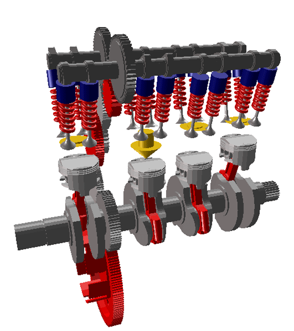

This is a 3D model of a four-cylinder engine in MapleSim software from Maplesoft. The software lets designers use symbolic and numeric techniques to diagnose vibration issues on machines powered by unsteady inputs such as internal-combustion engines.

Engine excitation model
Consider the internal-combustion engine. Its predominant vibration source is variations in gas-pressure torque, related to the cylinder gas pressure by the slider-crank geometry:
where Tg = engine gas-torque, Nm; Pg= cylinder gas pressure, MPa; A = lateral piston area, mm2; R = radius of the crank shaft, mm; and φ = rotation of the crank shaft, degrees The engine produces gas pressure for torque pulses that repeat after every complete working cycle. A four-stroke, single-acting engine has an interval of 4π or two crankshaft revolutions. A two-stroke engine has an interval of 2π. Due to this harmonic nature, the gas torque is usually represented as a Fourier series:
where ho = maximum number of required harmonic orders; and To= constant function of the cylinder firing angle, crankshaft radius, nominal power, and other constants.
Notice how this gas-torque equation consists of a steady part, To, that doesn’t excite vibration and a fluctuating part that does.
In engine-vibration theory, the harmonic order is the number of excitations during one crankshaft revolution. The fourth order repeats twice in a four-stroke engine, so the harmonic orders are half multiples — ½, 1, and 3/2. The fourth order repeats four times each revolution in a two-stroke engine, so there are no half-orders and the orders are integer multiples.
In the above gas-torque equation, the sine and cosine terms represent the harmonic orders and half-orders. The parameter ho is the maximum number of required harmonic orders, typically with a value from 8 to 12.
In some software, designers can define the harmonic orders for the engine (including half-orders for four-stroke engines) through symbolic equations using Modelica or custom component code. First determine the amplitudes of the sine and cosine terms for each harmonic order in the series from simulation or experimental data. Then enter these amplitudes into a model as 2D lookup tables (to represent the strength of all the harmonic orders over a range of the engine’s mean effective pressure).
For a four-cylinder engine, the designer must determine gas pressure for different speeds and load conditions. The usual practice is to test several engine prototypes on a test bed with a pressure transducer fixed inside the combustion chamber. The transducer measures gas torque in the chamber and integrates that collected data into the lumped model.
Excitation also varies with the rotational shaft speed, which directly influences the vibrational frequency, so the designer must analyze the machine vibrations over a range of engine rpm.
Likewise, to model a multicylinder engine, assume that all the cylinders have the same outputs, so the gas torque is the same for all of them. The only caveat is that there’s a phase difference between the fluctuating torques in the cylinders. (Any more detail about the model is beyond the scope of this article.)
