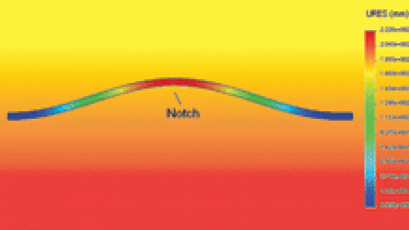

For an example of a linear buckling analysis, consider a model of a beam in compression (beam material is 1060 aluminum). The model is studied in two configurations: with a free loaded end, and with a sliding loaded end.
In the Notched beam figure, note the small notch — its importance will soon become clear. Also, try predicting which way the beam should buckle in each configuration.
In the Linear buckling, free end figure, why has the beam buckled in the wrong direction, and not toward the side where the notch is? Because the linear-buckling analysis only predicts the buckled shape and not the direction of buckling.
The Linear buckling, sliding end figure shows the beam buckling in the correct direction, but this is purely coincidental. The color legends with displacement magnitudes in both figures point out their meaninglessness. They show that linear buckling analysis cannot provide quantitative results for displacements or stresses.
In addition, linear-buckling analysis does not show what happens to a structure after buckling. Does the structure collapse, or will it retain the load-bearing ability in the buckled shape? How much will it deform when it buckles? To obtain more information than the BLF and the qualitative buckled shape, it is necessary to enter the domain of nonlinear buckling analysis.

Consider what happens in a nonlinear buckling analysis of the notched beam.
Note that in the figure Nonlinear buckling, free end, the red line shows that buckling happens at about 550 N, close to what the linear-buckling analysis predicted. The beam buckles towards the notched side as it should. Then, the displacement grows at an almost constant load. The result implies that the beam is capable of balancing the 550 N acting at an increasing load offset, but this is clearly unrealistic because the buckling of the notched beam initiates a chain of events leading to structural collapse.
