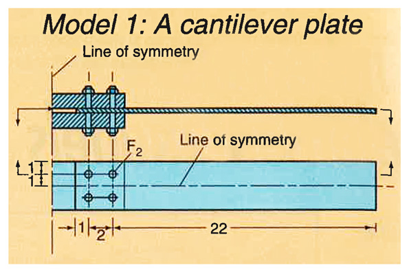

 Four bolts fasten the cantilever plate. The material is ASTM A36 steel, E = 293
106 psi, Poisson's ratio = 0.295, yield stress Sy = 36.03103 psi. Assume plane stress conditions. The plate is 0.2-in. thick and fasteners are 0.4-in. diameter. Uniformly distributed traction of 1.5 3 104 psi is applied on the right edge.

Several finite-element models show how easy it is to make bad modeling decisions and how to control modeling errors using a systematic approach. To simplify convergence-error analysis, the models are run in p-element FEA software.
Consider a cantilever plate of a constant thickness supported by four bolts. The right edge is loaded with a normal pressure. Find the distribution of von Mises stress in the plate.
To model the cantilevered plate, an engineer might argue that the bolt diameter is small in relation to the plate, so bolts-as-point supports is a reasonable simplification. Models based on these assumptions will provide results from a single run which may seem correct because large discretization errors mask the modeling error (point supports). Any finite-element solution corresponding to a particular mesh and polynomial degree of element will report a finite stresses. However, the sketch How a bolt hole deforms shows that refining the h-element mesh or increasing the polynomial order of the p-elements around the bolts reveals increasingly large strains concentrated around the point constraints.
The sketch indicates a deformed shape in the cantilever plate at bolt F2 magnified 100 times. Bolts are modeled with point constrains and the p-element order reaches eight. The underformed hole appears under the deformed shape.
