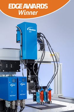

In tune with the medical devices development trendline toward smaller and lighter designs, Nordson EFD brought its PICO Nexμs jetting system, a small form factor, 24V, DIN-rail mounted jetting controller that monitors and coordinates jet dispensing through human machine interface at the point of dispense. The system can be mounted to a DIN rail inside the machine cabinet.
PICO Nexμs uses industrial Ethernet protocols such as PROFITNET and EtherNet/IP to establish communication with programmable logic controllers (PLCs). The precision dispensing system consistently applies accurate amounts of adhesives, sealants, lubricants and other fluids used in assembly applications. The product has been certified for PROFINET devices and controllers, and ODVA (Open Device Vendor Association) has confirmed successful conformance testing for the Ethernet I/P protocol.
PICO Nexμs was the winner of Machine Design’s 2024 Edge Award in the Automation & Controls category.  An informational product video can be found here.

  • Nordson highlighted its G4VPlus enclosure with two PICO Nexμs jetting systems angled to perform a needle-bonding application.
