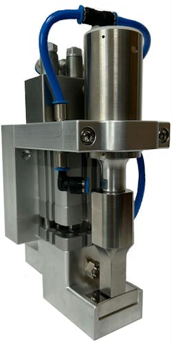

Global demand for lightweight, portable, durable and convenient packaging is good news for ultrasonic welding equipment manufacturers such as Rinco Ultrasonics. The company launched two new products at PACK EXPO, namely the Micro-35 packaging actuator and the FPA4500EM servo-driven pouch sealer.
Rinco’s new Micro-35 Actuator is a welding unit that operates on a 35-kHz frequency and was designed for continuous fin sealing and zipper crushing applications for the packaging industry.
READ MORE: Business Intelligence: PMMI Contextualizes the Place for Artificial Intelligence
Ultrasonic sealing or welding is a preferred sealing method that operates on the principle of converting electrical energy into high-frequency mechanical vibrations, typically in the ultrasonic range (around 20 kHz or higher). The heat is generated only inside of the materials to be welded. In addition to forming strong, airtight and watertight bonds, it offers speed, precision and sanitary sealing, making it ideal for assembling products like medical devices, automotive components and consumer electronics. The lightweight actuator system makes it viable for continuous movement zipper crushing applications where the actuator must move with the film.
Rinco’s press release characterized ultrasonic welding as a more sustainable process when compared to traditional methods and has the capability of sealing recycled and bio-based films as well as many paper-based materials. Thermal sealing processes are blind and often affected by ambient conditions and are unable to confirm seal quality. Rinco noted that intelligent ultrasonic systems provide a high level of process data, offering insight into the sealing process.

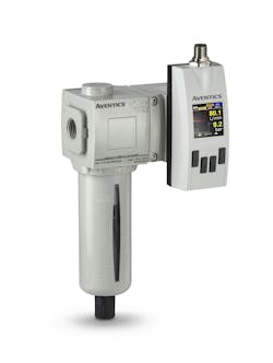

Combined with the Emerson Compressed Air Manager, the Energy Manager presents a streamlined view of energy costs and compressed air usage across a packaging line, factory and site. To this end, Emerson now also offers a high flow model of an advanced sensor that propels compressed air monitoring beyond individual machines to benefit larger air lines and systems. The Aventics Series AF2 Flow Sensors brings expanded capabilities to compressed air consumption and energy efficiency, allowing users to optimize across an entire packaging facility and improve overall plant sustainability.
