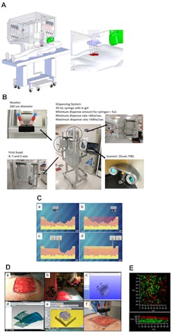

Skin bioprinter prototype. (A) Schematic demonstrating scale, design, and components of the skin bioprinter. (B) The main components of the system consist of 260 µm diameter nozzles, driven by up to eight independently dispensing systems connected to a print-head with an XYZ movement system, in addition to the 3D wound scanner. All components are mounted on a frame small enough to be mobile in the operating room. (C) Skin bioprinting concept. Wounds are first scanned to obtain precise information on wound topography, which then guides the print heads to deposit specified materials and cell types in appropriate locations (Images courtesy of LabTV - National Defense Education Program, Washington, D.C.). (D) Example of skin bioprinting process, where markers that are placed around the wound area used as reference points: (a) prior to scanning with a hand-held ZScanner Z700 scanner (b). Geometric information obtained via scanning is then inputted in the form of an STL file to orient the scanned images to a standard coordinate system (c). The scanned data with its coordinate system is used to generate the fill volume and the path points for nozzle head to travel to print the fill volume (d). Output code is then provided to the custom bioprinter control interface for the generation of nozzle path needed to print fill volume (e, f). (E) This system facilitates the depositing of multiple cell types with high precision and control. The layering of fibroblasts (green) and keratinocytes (red) is shown.
The new bioprinter from WFIRM combines the delivery systems of inkjet printers with mobility and the scanning capability of different topographies. The research team outlined its design and printing approach in the paper “Bioprinting of Autologous skin Cells Accelerates Wound Healing of extensive excisional Full-thickness Wounds.” The main components of the system are a handheld 3D scanner and a print head that can move in any XYZ direction. The print head contains eight 260 μm diameter nozzles, each driven by an independent dispensing motor. The printer components are mounted on a small frame which can be used in an operating room. The system is 79 cm wide (patient head-to-toe direction) by 77 cm deep (cross-patient direction). The system includes a robotic arm and, when fully extended, adds an additional 50 cm—combining for a full reach of 127 cm.
The scanner attached to the printer system is the ZScanner Z700 scanner from 3DSystems. As noted, the scanner is handheld and easy to use. It can capture the entire wound in one continuous scan which results in a computer model of the wound. The model is processed via Geomagic Studio and imported into Artcam 3D software to obtain the full volume and the nozzle path needed to print the fill volume. The wound is split into Z axis layers for its depth, corresponding to dermis and epidermis layers, and each Z-axis layers is overlaid with XY lines that cover the entire wound.
The cartridge-based delivery system is like that used in traditional inkjet printing. The pressure-based delivery system uses three components to print on the wound.
