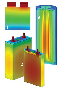

Software predicts electrothermal-cell behavior based on battery pack geometry, internal architecture, and volumetric and gravimetric densities, as well as the environment’s ambient temperature. 1. Pouch cells get hottest at their terminals due to localized current density but good heat transfer out of the core. 2. Prismatic battery cell and cutaway: Prismatic cells have large thermal masses that prevent concentrated hotspots. However, casing can retain diffuse heat in the cell core. 3. Spiral-wound cylindrical battery cells get hottest at their core because the layers’ heat-transfer resistance makes an adiabatic condition.
