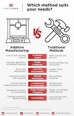

When Not to Use AM
There are specific cases where traditional fabrication methods still outperform AM, especially when consistency, regulatory certainty or cost per unit is the primary concern.
High-volume production introduces limits. If the same guard needs to be produced in large quantities, additive loses its edge. The per-part cost doesn’t scale down the same way as molded or stamped components. Injection molding, in particular, becomes more cost-efficient once the upfront tooling investment is spread across hundreds or thousands of parts.
Not all geometries need complexity. Some guards are simple by design. A flat steel screen, a standard panel with bolt holes or a basic box enclosure might not benefit from additive’s design flexibility. In these cases, subtractive methods are faster and already optimized. Simplicity doesn’t need disruption.
Material properties can be a constraint. While AM polymers continue to improve, not all printed materials offer the mechanical performance, impact resistance or thermal tolerance required in industrial environments. In heavy-duty applications (high-impact zones, high heat exposure or abrasive contact) conventional materials may still offer greater reliability.
Regulatory clarity can also favor tradition. When a guard is built from known materials like powder-coated steel or extruded aluminum and formed using familiar processes such as welding or CNC machining, the path to compliance is typically clearer.
OSHA’s 29 CFR 1910.212 requires guards to be strong enough to prevent contact, firmly secured and not create additional hazards. In electrical or control panel environments, NFPA 79 governs construction requirements. Where functional safety systems are in play, ANSI B11.19-2019 outlines expectations for risk reduction and verification.
Traditional materials often come with pre-established compliance documentation, such as third-party data sheets, certifications and performance history, all of which reduce the burden on the engineer to prove equivalence or safety. Additive processes, by contrast, may require custom validation, testing and explanation, especially if the material or method lacks precedent in safety-critical applications.
NOTE: OSHA might not have AM-specific regulations, but the end result still has to meet all the usual standards. While the rules aren’t concerned with how the part was made, they do care that it works the way it should.
