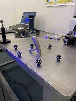

Scanning the Putter Using a Handheld Device

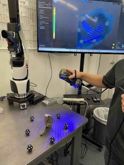

One of the most challenging tasks that may come up is transferring an odd-shaped part to the computer. Fortunately, specially designed hand scanners built precisely for this purpose are becoming much more accessible. The scanner used for the putter is an infrared laser about the size of an old telephone receiver. As it passes over the part, it bounces back the depth of each point on the surface, laying down millions of points to create a digital representation of the part. The way it measures and reports the topology of the part is essentially the same technology used to scan the bottom of the ocean floor to get its topography.
In this application, it was easy to scan the putter, but the handheld device is able to scan objects up to the size of a rocket. It can even scan around mating areas, where the part is going to connect with another plane or component. This is crucial when brackets and other connections are required for an assembly. Those mating parts around that assembly can even be used as fixturing to hold the part. What better way to design a work-holding tool during machining than to use the connection between mated parts?
Use Reverse-Engineering Software to Build and Validate a 3D Model
As the putter was scanned, those millions of points showed up in the system automatically. The shop’s reverse-engineering software began building a 3D model of the part before the scanner was even set down. It took the digital point cloud provided by the scanner and overlaid the correct surfaces. The software includes a specific feature that inspects the model in real-time as it’s being built. Those surfaces were then converted into a solid model that was pulled into the local CAM system. This primary model is kept as a type specimen; it’s the model that will set the foundation and be considered “law” for future inspections.
