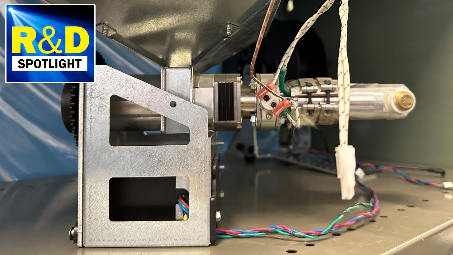

For Braam Meij, one technology has the makings of such an opportunity. ReDeTec, a Toronto-based small business, has developed MixFlow, a filament extrusion system that promises a new way to melt plastics. Whereas traditional systems churn a screw through molten plastic, ReDeTec’s novel filament extrusion design separates the drive section and melt section with a thermal isolator, allowing independent control of temperature and pressure, explained Meij, CEO of BM3 Ventures Ltd., and an early-stage investor in the plastics extrusion system.
ReDeTec’s extrusion technology is game changing because it uses 50% less energy than competing systems and offers higher throughput and more automation, Meij said during a call to invite Machine Design to visit ReDeTec’s R&D facility in Toronto. “The solution has disruptive potential,” he touted.

With traditional plastic parts production processes, molten plastic is mixed around a long screw. The advantage of this method is that it ensures a consistent flow of molten plastic, which is needed for producing high-quality extruded products. The main drawback from energy efficiency perspective is the system’s limited adaptability and control capabilities.
“You need full-time trained operators to run these machines,” Oosterman explained. “It’s a relatively intensive task. What MixFlow does differently is that it completely separates the screw or the feed auger from the plastic, and this allows us to have significant benefits in energy efficiency. [Add to that] the level of automation we’re able to achieve. And the quality of the plastic itself is notably higher. There’s less degradation from thermal and mechanical stress.”
ReDeTec’s extrusion of plastic materials patent covers a system where the auger feeds room-temperature plastic into a separate melting chamber that melts and mixes plastic uniformly without any interaction from the screw. The melting largely occurs through polymer shear or friction heating.
“Of course, there’s much more to the proprietary process to make it work," said Oosterman. “We figured the best IP protection strategy was both—we have the patent, and we have all the other techniques you’d have to figure out as well. So, you’d need to both crack the code and violate the patent to copy it.”
In ReDeTec’s first pilot using a large extruder, their engineers ran four different polymers through the machine. Tests were confined to low-volume extrusion and focused on compounding. “We’ve done polyethylene (PE), polypropylene (PP), ABS (acrylonitrile butadiene styrene) and nylon, and we’ve run those with various additives, compounds, etc., all at very low-volume, almost lab-scale extrusion,” explained Oosterman.
