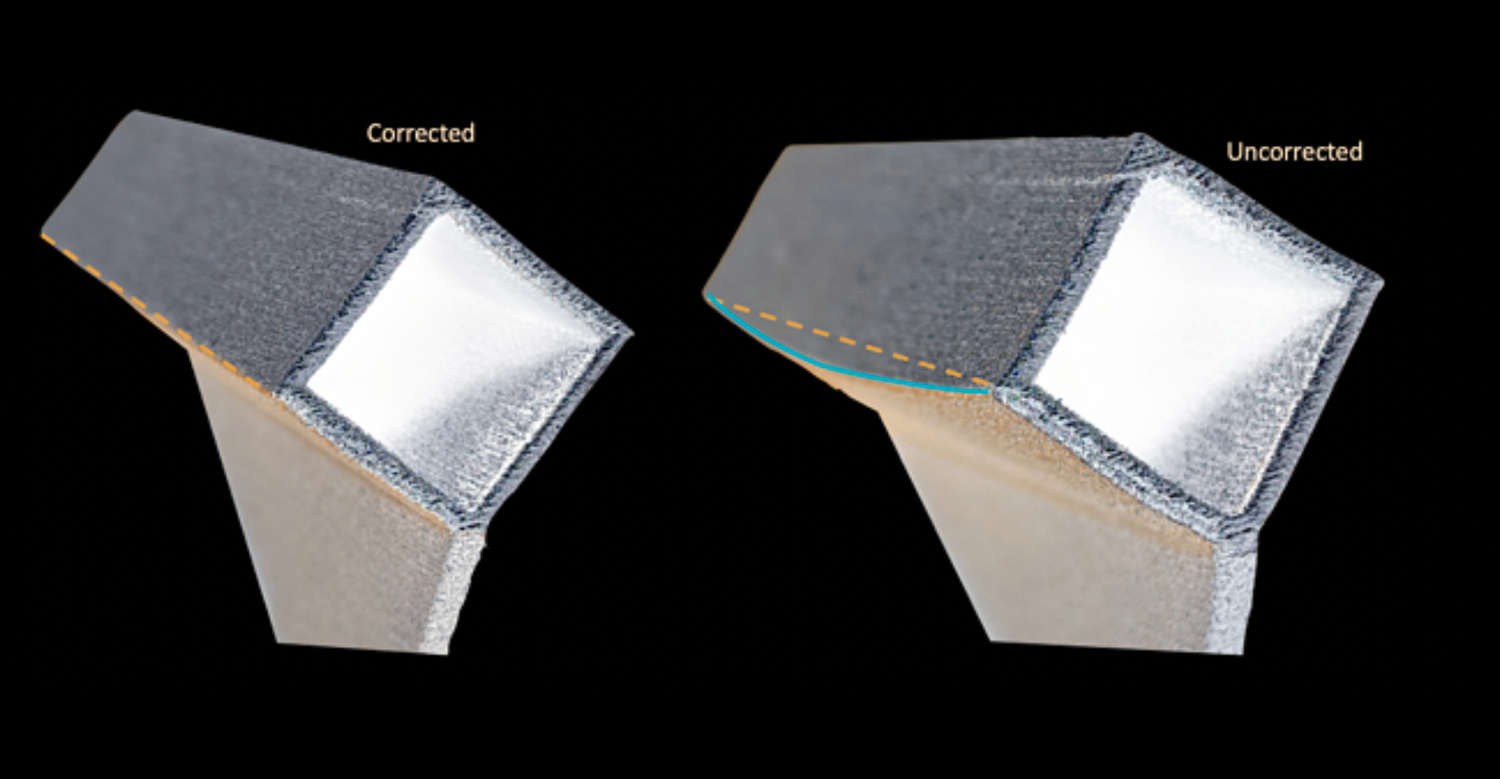

Two sample parts of the same hollow rectangular prism are 3D printed horizontally. The image on the right shows out-of-plane deformation (red line), common on 3D-printed parts due to residual stress buildup during printing. On the left, an accurately printed part was corrected by printing-simulation software that pre-deforms the design before manufacturing to account for printing stress. (Courtesy: Velo3D)
One reason for this is the large amount of residual stress induced in the part by the repeated heating/cooling from the laser beam during the layer-by-layer melting. This stress can result in the part distorting and warping as it prints. As an industry, we add supports to hold parts in place and then heat-treat after the build to try to minimize these distortions. Alternatively, we turn to tribal knowledge to modify the geometry sent to the printer to address part deformation ahead of time.

The machine-specific software can simulate the build directly from a CAD file and identify areas where the part will change shape during the print. The engineer can then adjust the part or use the built-in deformation correction capability. This automatically adjusts the print plan so that the stresses incurred during printing distort it into the correct shape.
