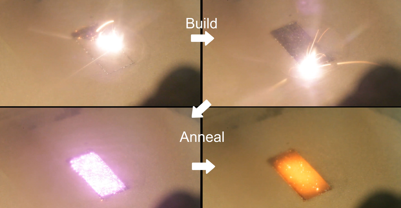

For the purpose of the study, LLNL engineer Will Smith built small, bridge-like structures from 316L stainless steel using laser powder bed fusion (LPBF). He let each layer solidify before illuminating their surfaces with the diodes, initially at full power and then ramping down the intensity over a period of 20 sec. The result was akin to putting the part in a furnace after each layer, as surface temperatures reached about 1,832°F (1,000°C).
This image shows the building and annealing of a rectangular block of stainless steel 316L. The first and second panels are the focused scanning laser melting the powder layer into the underlying part. The third panel is the diode turning on and illuminating the surface of the part to heat and anneal it. The last panel is right after the diode turns off, showing the block is at high temperature (>950°C).
