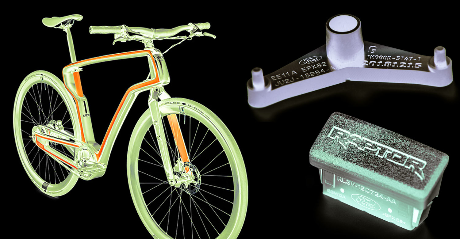

Ford and Carbon have teamed up to use 3D printing to produce finished parts. This is an exciting step forward and will help to digitize Ford’s production line.

Arevo, a carbon fiber 3D printer, is focusing on software to optimize the carbon fiber printing process. By looking at the process from the software point of view, the fiber is laid in the best direction to increase a parts strength based on how the part is used. This new printer has a continuous carbon fiber wetted into the filament, which needs to be cut between layers, but the software also reduces the cutting of the fiber to only when it is necessary. According to Avero, random fiber can improve strength, but controlling fiber orientation could make a part five times the strength of titanium at one third the weight.

In our next installment, I’ll cover how Stratasys is pushing for carbon fiber tooling, Ford and Carbon’s work on the F-150 Raptor Auxiliary Plugs, how Ultimaker’s is moving farther into industrial printing, and how Optomec acquiring Huffman will accel the company into the repair and aftermarket markets.
