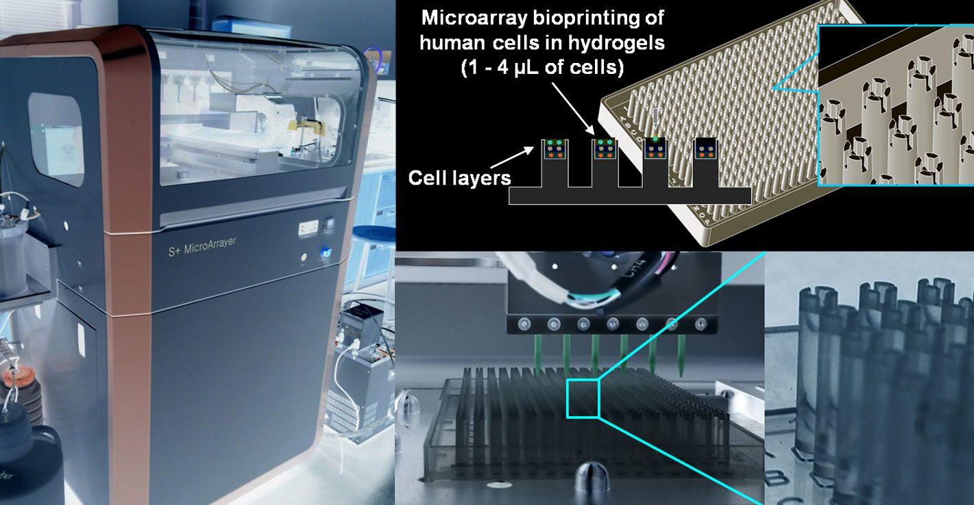

                After preparing the bioink, the solution can then be “printed” for precise placement of human cells using a bioprinter, which can have different printing mechanisms, such as piezoelectric, microsolenoid valve-based, microextrusion-based, and laser-assisted printing (Fig. 1). These methods represent three major technologies used for 3D printing: inkjet/droplet, extrusion, and laser. The inkjet/droplet approach focuses on using a technique that creates variations in pressure to form droplets of bioinks. These droplets are then precisely placed layer-by-layer on a substrate to create the tissue. However, it is limited to using bioinks that are not highly viscous. Extrusion technology uses some type of pneumatic or mechanical dispenser to release a stream of bioink onto a substrate. This approach is not limited to viscous bioinks, but the cells in these bioinks do suffer larger amounts of sheer stress. Lastly, the laser approach pulses a laser beam at a glass slide coated in a laser-absorbing layer and a layer of cells and biological materials. The laser excites these layers, discharging droplets containing cells. This approach faces neither limitation from the two other methods, but large tissues are difficult to create due to the width of the laser and metallic residues may contaminate the sample.
1. Photographs of a microsolenoid-based bioprinter and a dispensing head with six microsolenoid valves for dispensing biological samples.

This is only made worse as these platforms are also poorly suitable to provide high-throughput screening. These challenges provide an opportunity for new technology to be developed. The below images represent a cutting-edge 384-pillar plate for miniaturized 3D bioprinting that can be placed within a standard 384-well plate (Fig. 3).
3. (Top image) Schematics of a 384-pillar plate with sidewalls and slits (384PillarPlate) for bioprinted tissue cultures. (Bottom image) Photographs of an injection-molded 384PillarPlate loaded on a bioprinter for layer-by-layer cell printing and culture.
The gaps located at the top of the pillar provide an area in which the bioink can be printed. The walls surrounding the gaps help hold the bioink in liquid form prior to polymerization and have spacing between them to allow for diffusion of nutrients when the manufactured tissues are submerged in a media solution required for cell growth or differentiation. This system can also be used without an expensive 3D bioprinter as it has been shown to be able to create tissues by simply dipping these pillars into a bioink and polymerizing the remaining bioink in the gaps of the pillar tops. The 3D cell cultures created in this platform is also able to be screened in high-throughput because of its ability to be paired with standard 384-well plates, addressing many of the issues with current 3D cell culture platforms. Although the technology is not fully perfected, it shows great promise to create miniaturized human tissues and advance the field as a whole.
