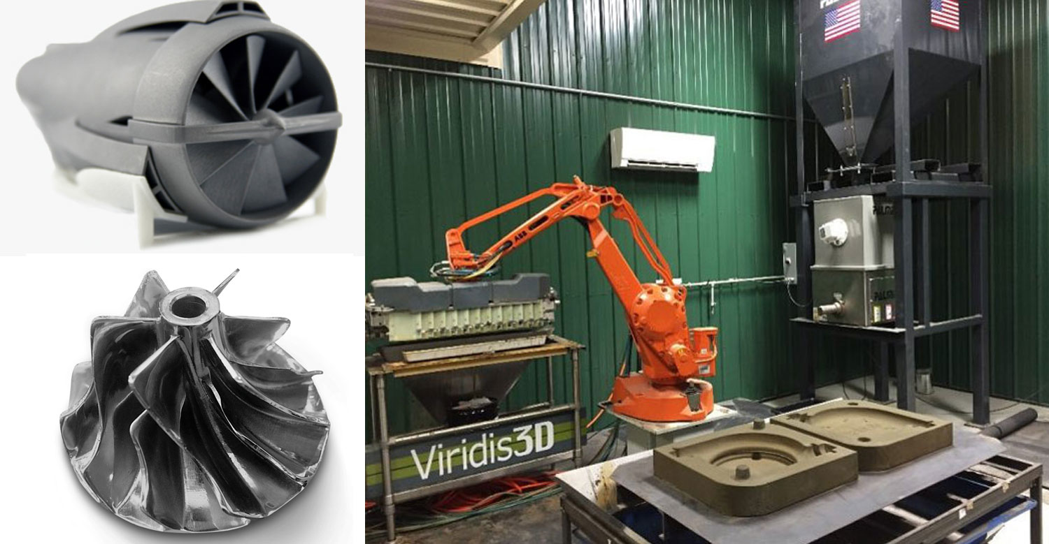

Electron Beam Melting (EBM) is similar to SLM, but an electron beam is used instead of a laser. Bed temperatures are higher (~870 K), and the EBM environment is performed in a vacuum rather than the Inert gas used in SLM. One drawback to EBM is that is involves more process parameters that means the process will take more expertise and time to optimize. The NCBI paper outline the following parameters involved in the EBM process:

The complexity of the process limits EBM materials. EBM has been known to use Ti grade 2, Ti6Al4V, Inconel 718, and CoCrMo. SLM cannot produce many brittle materials such as intermetallics because its high cooling rate will cause internal stresses. Longer cooling times can be both a pro and a con for EBM.
Binder jetting (BDJ) is a powder bed process but instead of lasers or electron beams, a binder agent holds the powder together. A (green) part is produced faster than any of the other powder bed processes, but this is only the first step. Post-processing—such as curing, de-powdering, sintering, infiltration, annealing, and finishing the part—will often take more time than creating the first green part.

Soft materials. There are design requirements that may lean towards a type of material. From the previous example, binder jetting (BDJ), selective laser melting (SLM), and EBM are all competitive when considering metals/composites. However, EBM temperatures can exceed 870 K and are a concern if a material has a low boiling point, such as Al/Mg/Zn.
This table shows the mechanical property difference of Ti6Al4V when processed with EBM and SLM. SLM’s high cooling creates a better martensitic structure that increases the strength and brittleness of the material.
When considering cooling temperature, it should be noted the powder bed will need to cool before parts can be removed. Higher temperatures will increase the time between printing and removal. In the case of EBM, a powder bed may need to sit overnight. This time slows production and can increase part cost.
