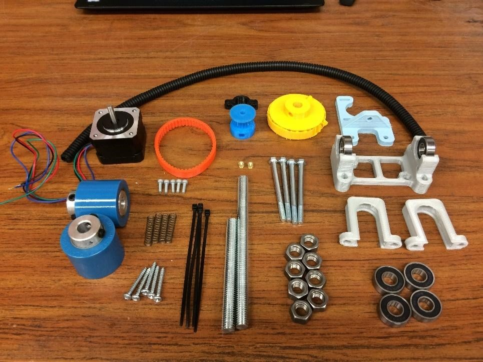

Some of the parts for the recyclebot can be made on a 3D printer.
