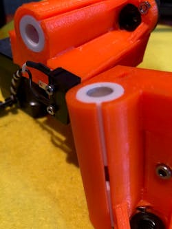

Hilube bushings (white) mounted in a 3D printer on a smooth guide rod.

Here’s a close-up of the Vesconite Hilube bearings used on a 3D printer.

Hilube has an unlubricated coefficient of friction on steel of 0.1, and can go as low as 0.08 on polished steel. This makes bushing movement along the rod particularly smooth and eliminates the problem of the jerky motion (stick slip) when the extruder on the 3D printer moves to a new location. Hilube bushings can be made to specifications with appropriate tolerances and delivered globally via distributors or by courier, which simplifies logistics. And using bushings made to specifications and tolerances has also improved the quality of 3D printed parts as bushing play can be minimized.
The Hilube bushing for 3D printers is self-lubricating, wear resistant, and has a low coefficient of friction.
