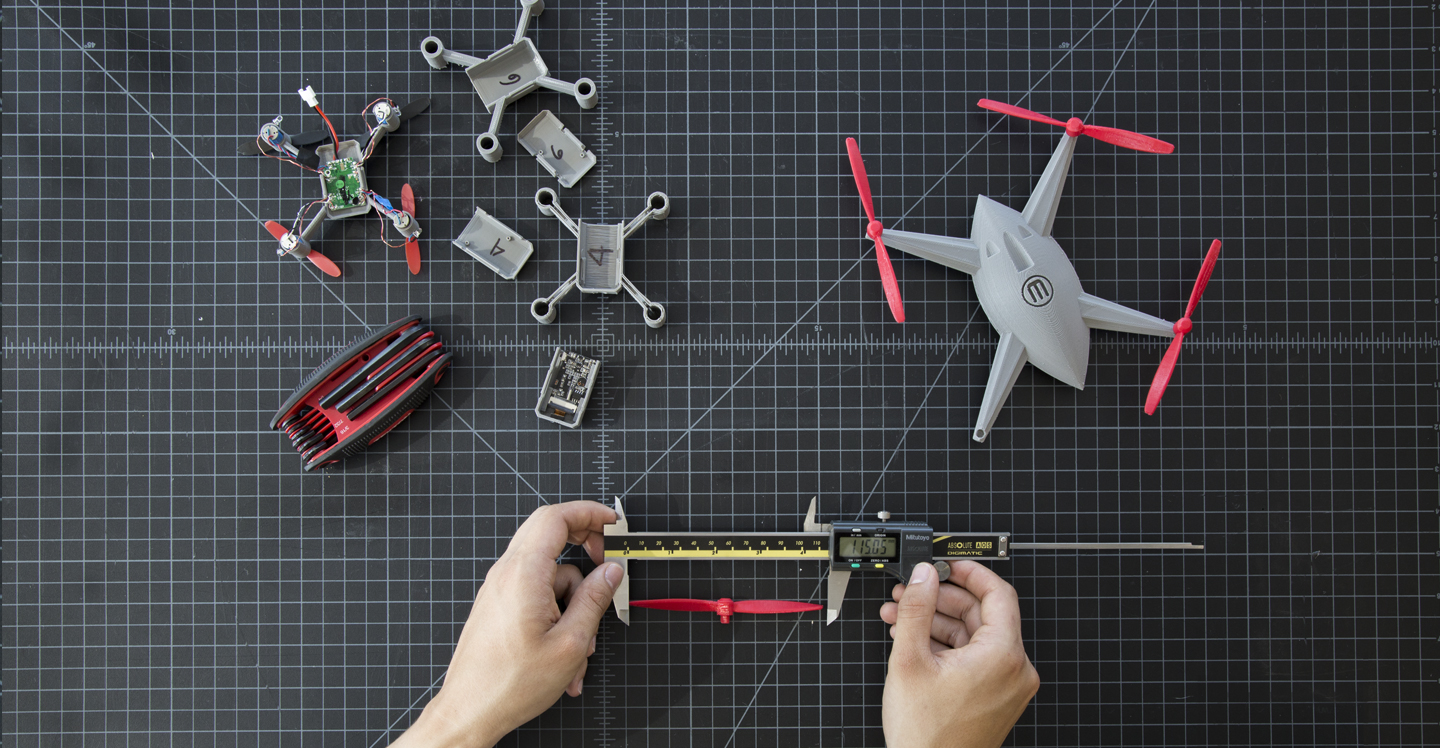

As an industrial designer, I’m always fascinated by the way things work, and drones are no exception. That’s why I decided to reverse engineer and rebuild one. I dissected the components involved, designed the new body in CAD, and used a 3D printer to bring my final design to life. There was plenty of trial and error, of course, but the project sharpened my design and engineering skills while helping me to better understand the design decisions that go into building an actual drone.
Step 1: Dissect and Evaluate the Components
I began the reverse engineering process by carefully disassembling the original drone to expose all of the individual parts. By taking the time to learn how each part interacted with the others, I was able to determine the constraints of my redesign.
For this particular project, I had to consider the fixed distance between the motors. The weight of my new design needed to be close to that of the original drone as well. These aspects of the design couldn’t change, but I could experiment with other parts: the location of the ports, the positioning of the boards, the wire routing, and the overall structure and durability.
Taking the time to dissect and really understand the original drone proved to be one of the most important steps in the entire process. Once I determined how I would actually recreate my own drone, it was time to take my ideas from my sketchbook to my computer.

Using the information I learned while taking apart the drone, I took measurements to design blind solids in CAD, which acted as placeholders for the fixed constraints in my new design. Calipers were a must for this step. Used to measure the distance between opposite sides of an item, calipers are an ideal tool when working on small-scale projects. My tip for using them: Try to get your dimensions down to at least 100 micrometers.

With the prints finished, I labeled everything before taking them off the build plate to begin assembly and weighing. This is the stage where I learned the most. Some parts didn’t fit perfectly, some arms were too heavy, and some component layouts that made sense on the screen were obvious failures in the real world.
So I took this batch of learnings and went back to iterating the individual components.
