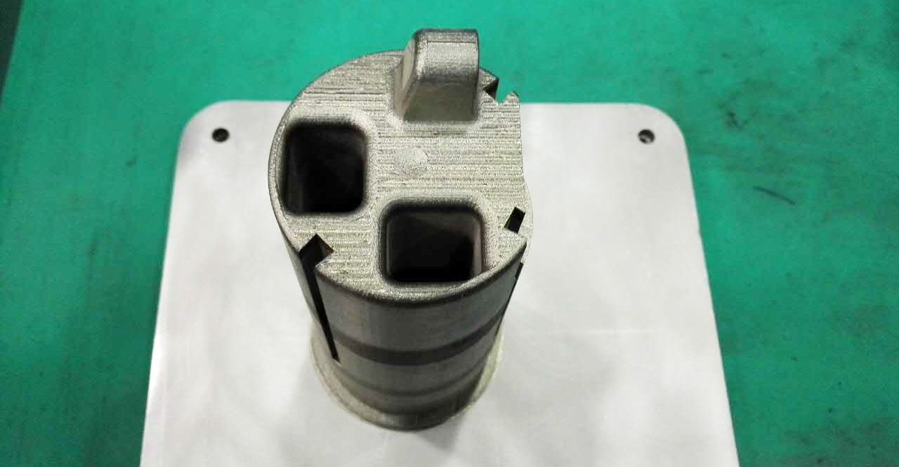

It took complex modeling software to determine the best architecture for internal, conformal cooling channels for this cylinder.

3D Metal Printing and Conformal Cooling
The highest potential for improving part quality and speed lies with metal 3D-printed, conformally-cooled injection mold tools. Right now, the vast majority of conventional tools uses line-of-sight cooling channels machined out of aluminum or steel cores and cavities.
These are relatively straightforward to manufacture, but they are inherently limited in their ability to follow the geometries for complex parts. As such, cooling efficiency decreases, with corresponding increases in cycle times (and therefore, costs). Part quality can also suffer with sink marks, weld lines, and distortions caused by unbalanced heat transfer in the mold.
A plastic injection mold tool made with 3D printing uses cooling channels that conform closely to the shape of the cavity. These channels deliver water exactly where it’s needed for maximum efficiency, and in the right volume. Conformal channels printed this way can have different cross-sectional sizes and shapes at different points along their lengths as necessary, and also be printed close to the tool wall. The results of this improved cooling are drastically reduced cycle times and significantly improved part quality.
To get the most out of this innovation, tooling engineers will need to become more familiar with sophisticated mold-flow analysis to model heat transfer. Also, printing such a tool successfully is a complex operation that requires another skilled engineer operating a 3D printer the can create metal parts. Tool size will be limited to the size of the print bed, which is smaller than conventional CNC machines allow.
Also, there are fewer raw materials to choose from. Taken together, 3D printed injection mold tools are likely to be more expensive than their conventional counterparts, but these costs can be recovered over a long production runs due to faster cycle times and better parts.
