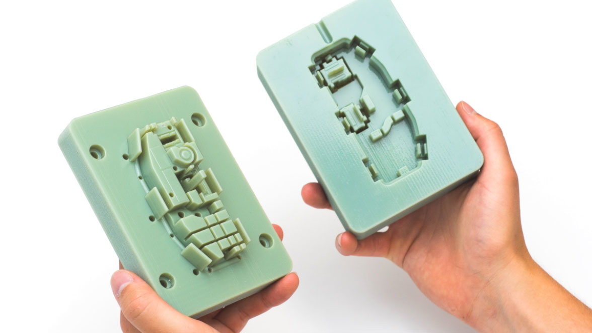

This article will walk through how to 3D print molds for silicone parts. 3D printing molds is not new, but it shows a different perspective on how 3D printing can help expand your building abilities. In the following examples taken from MakerBot, it took about 0.5 hours to make a silicone part from a 3D-printed mold, and 1.5 hours to make a silicone mold from a 3D-printed part. This time will vary, but it offers an idea to how fast 3D printing can offer a mold for prototyping or parts.

After getting a CAD design that works well as a mold, and finding a suitable material, print the mold. From this point, it is more or less standard operating procedure. In the example from MakerBot, a 3D-printed mold is used to make a part out of silicone. This is a nice material to mold because it doesn’t require heat or generate heat that degrades the mold. In addition, removing soft material such as silicone from a mold is often easier, or requires less force, than ridged materials. Removing parts with less force can extend the mold lifecycle.
