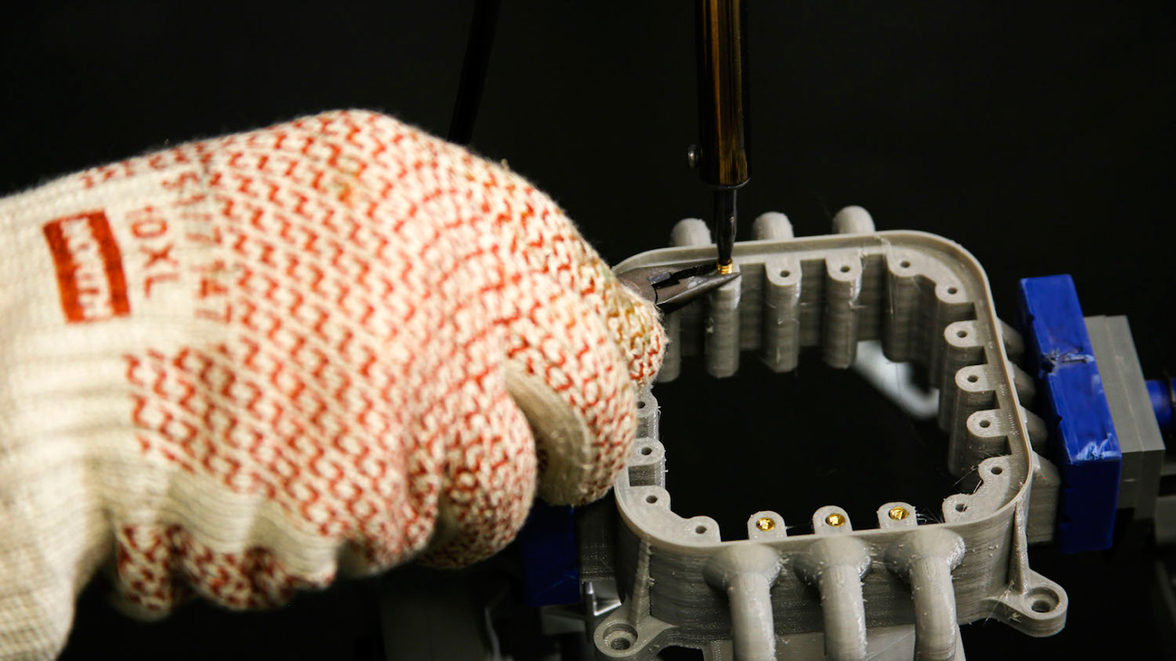

Adding Inserts
While certain materials and designs make it possible to 3D-print living hinges and clips, expectations for such parts being long-lasting can be in jeopardy because these features may succumb to fatigue. To achieve the goal of having a long lifetime, a better option is to use metal threaded inserts.
Before printing, you might want to increase the shell layers the inserts will press into, to offer more material and strength. This is especially important if you plan to drill and tap into the part directly.
Oftentimes, 3D-printing holes can be slightly undersized because of the geometry and the process. However, this could be handy for inserts. When buying your threaded inserts, the suggested diameter size for the model should be given. Since the inserts will be melted into place if the diameter is slightly tighter than needed, it may not cause an issue.
In a guide from MakerBot, it shows How to Install Threaded Inserts into Your 3D Prints. (Credit: MakerBot)
Inserts can be installed with a soldering gun and needle-nose pliers. Be careful when heating the insert. If the metal is overheated, it will melt the material away, making the hole too large. To prevent overheating, try using the pliers to hold the insert in place while using the soldering iron to push the threads into place. Once it looks like the insert has started to melt into place, remove the soldering iron from the insert. Then, apply the soldering iron to the thread again. Gradually push the insert in a little more each time when you add heat.
Note: Make sure the inserts are square to the surface that it’s being mounted on.
