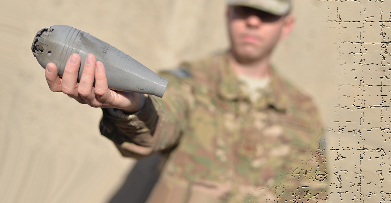

3D printing has also helped with training for the Explosive Ordnance Disposal Marines. Shown is a bomb that could be a threat to public safety. However, shooting a steel slug through the fuse will render it a paperweight. These bombs originally cost $100 each. Now, though, the military can train more extensively because 3D-printing them costs a mere $5.
For this research, the military didn’t 3D-print the TNT or thermite, but rather the containers that holds the explosive charge. A team of Explosive Ordnance Disposal Marines tested the 3D-printed containers in early October 2017. The test was successful.
