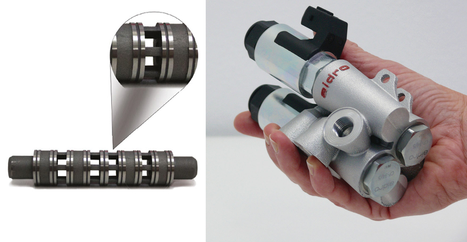

In addition, the design and production of a stackable hydraulic valve was improved with 3D printing (Fig. 2). The direct-operated pressure-reducing valve had been made of steel and zinc-plated to resist corrosion. When Aidro’s customer needed a small quantity of the valves, the lead time and cost of CNC machining were not acceptable. Instead, the valve was redesigned for 3D printing in stainless steel, which reduced the weight by 60%. Its structural walls were as strong as in the original part, and the new design was tested under pressure to 250 bar with comparable results.
2. The hydraulic valve on the left was machined from steel, and then zinc plated for corrosion resistance. The redesigned valve (right) was produced by 3D printing in stainless steel. The 3D-printed version weighs 60% less but maintains the same strength as the machined part. The conventional part could have been made lighter by machining away (subtracting) unneeded material, but with much higher production costs. (Courtesy of Aidro SrL)

Aidro redesigned a valve spool to be 3D-printed with new hole forms, replacing round holes with square holes (Fig. 6). This increases the area of the oil passage inside the spool and reduces pressure drop.
6. The original valve spool (left) had round holes, required with CNC machining. The spool redesigned for 3D printing has square holes with larger area to reduce pressure drop. (Courtesy of Aidro SrL)
