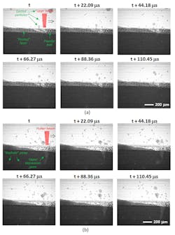

Argonne selected snapshots from larger datasets (i.e., each complete set includes a total of 340 images covering a 7.5-ms timespan), to show the details of laser-sample interaction within a ~110 ms time window (see figure below). The laser beam positions are marked in red in the first image of each image series. On the left of the laser beam, a “printed” line can be observed, while the un-melted powder bed is on the right side. Underneath the laser beam, a vapor depression zone inside the metal base can be detected. In the case shown in (a), a moderate laser power is applied. A small depression zone is formed and some particles (including molten metal and raw powders) are spatter ejected from the powder bed by the metal vapor. This is a heating mode often referred as conduction mode.
Argonne researchers have provided a first-of-its-kind in-situ observation and measurement of the metal additive manufacturing process. Shown here are dynamic x-ray image series of two laser powder-bed fusion processes of Ti-6Al-4V with different laser powers (a: 210 W; b: 360 W). In both cases, the laser beam with a size of ~100 μm is scanned from the left to the right with a speed of 0.4 m/s to “print” one line. The frame rates of two data series are both 45.3 kHz, and the exposure time for each image is 0.1 ns. Note the straight lines in the middle of each image are the top edges of the glassy carbon plates, which sandwich a Ti-6Al-4V base plate and a layer of powders on top. The thickness of the metal base and powder bed along the X-ray beam direction is 0.5 mm.
In the case shown in (b), the higher laser power generates a much deeper depression zone, and at the same time, more particles are ejected. Also, a track of pores can be observed along the laser path near the depth of the depression zone. The formation of one such pore is clearly revealed in this image series. This heating mode is called “keyhole” mode, in which an excessive thermal power is deposited on the sample. The porosity formed in this heating mode is often referred as “keyhole” porosity, which is one of the major defects in the additively manufactured metal parts.
