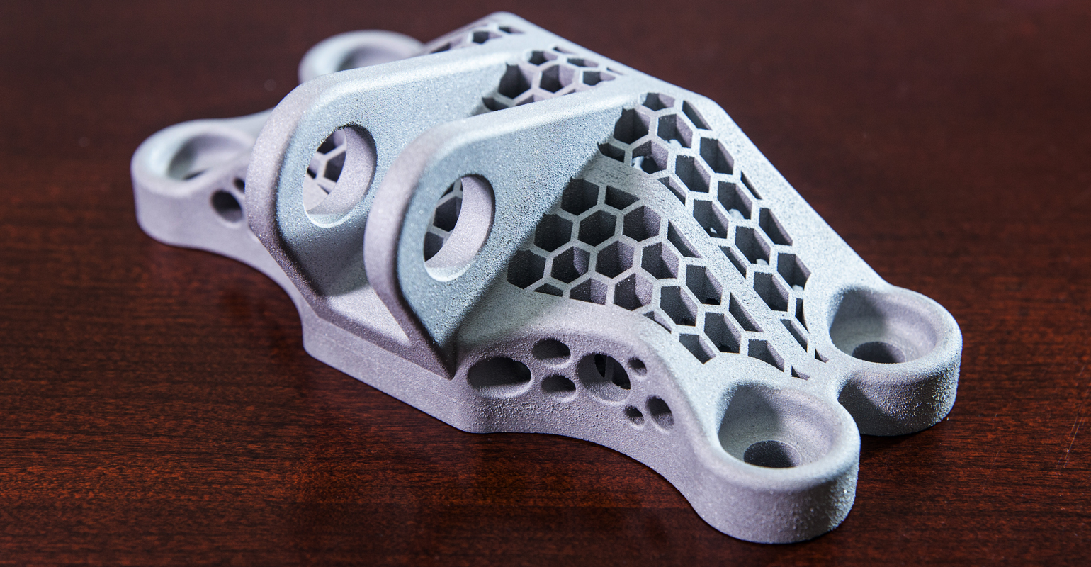

A geometrically complex DMLS part.
DMLS, being a 3D-printing process, is falsely associated with the simplicity implied from other 3D-printing processes.
Preparation of the design before being sent to the DMLS machine and the post processing afterwards can be time consuming. All modern manufacturing processes have before and after steps. CNC, for example, requires the programming of tool paths, machine setup, cutting and grinding, then polishing and de-burring afterwards.
