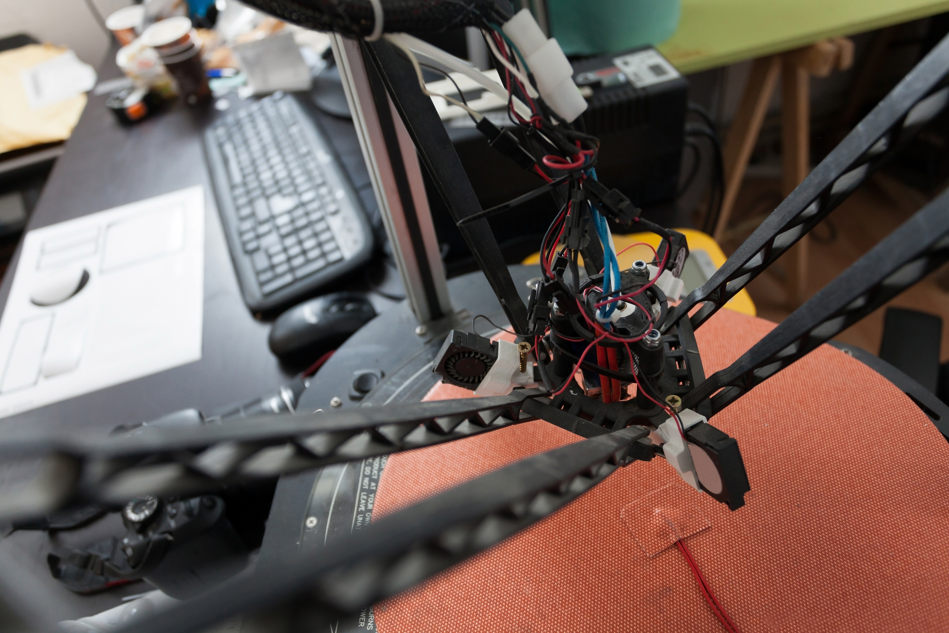

For me a heated bed was an absolute must. Without a heated bed you must use a variety of tricks in order for the print to stay secured to the bed during the print. Without the heated bed the user must apply a thin layer of glue from a glue stick or cover the bed in blue painter’s tap. This will keep the print secured to the bed during the print, but it leaves the bottom of your print looking less than satisfactory. Using these extra techniques can also be a hassle.
3D printer bed-adhesion failure

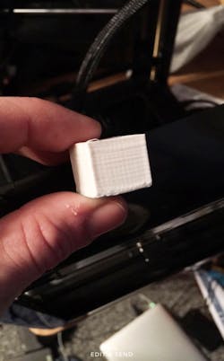

3D printers are able to print at a layer height starting as high as 0.4mm and go as low as 0.1mm or lower. As layer height is lowered, the finer details the print will have, and in theory the better it will look. But this is not always the case. When using a 3D printer, you must experiment and figure out the sweet spot for your specific printer’s layer height.
3D printer issues from poor layer height settings

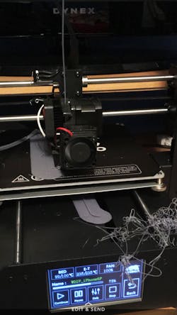

Retraction is what happens whenever the 3D printer needs to move from one spot of the print to another without extruding any material. The printer will retract the filament into the nozzle to keep it from leaving strands of material across the print. This is a key setting because too much retraction and when the printer stops traveling and begins to print again, the material may not begin to flow immediately, causing imperfections. Too little retraction and whenever the printer travels it will leave strings of filament that will make the print look undesirable.
Temperature
The last key setting is the temperature of the hot end. The hot end is where the filament is melted and then extruded out of the nozzle. If the hot end is too hot, it can also lead to stringing of the filament across the print. However, if the temperature is too low, the layers of the print will not fully bond together.
