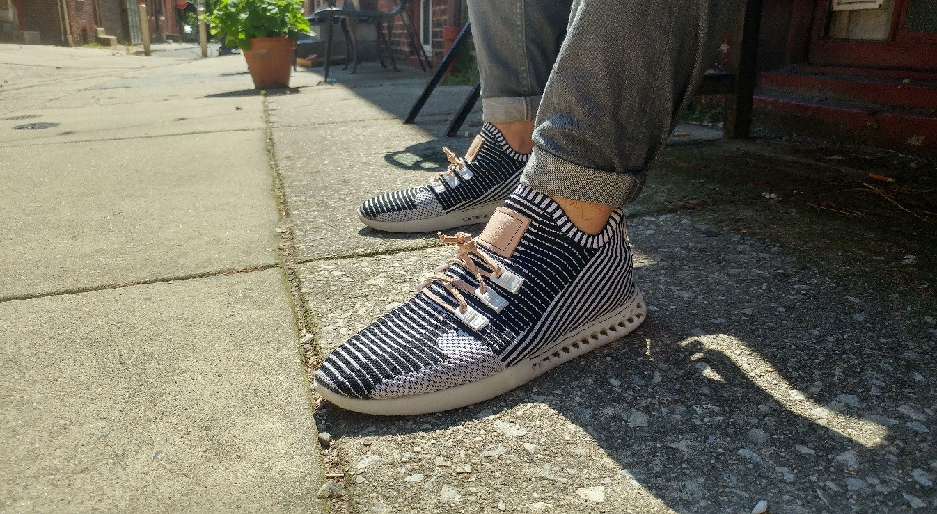

footprint intro pic (2)

Here is a finished product with altering density and a custom fit. (Footprint 3D; Synopsys).
During manufacturing, it is also possible to use a vacuum bag as a low-cost alternative to a hydraulic press; this method creates high pressure contact on all sides for gluing. Soles can then be combined with the rest of a shoe to create a unique product that is ready to be used by the customer. Keeping these costs down and maintaining an economic process does, however, mean having to keep an eye on potential problems with the printing process. For example, when working with very precise designs, any small defects can upset the printing, adding more costs to the overall work. While the hydraulic press is superior, it's also very costly and not necessary. Vacuum bagging can be used to quickly adhere the upper to the printed sole in prototyping.
