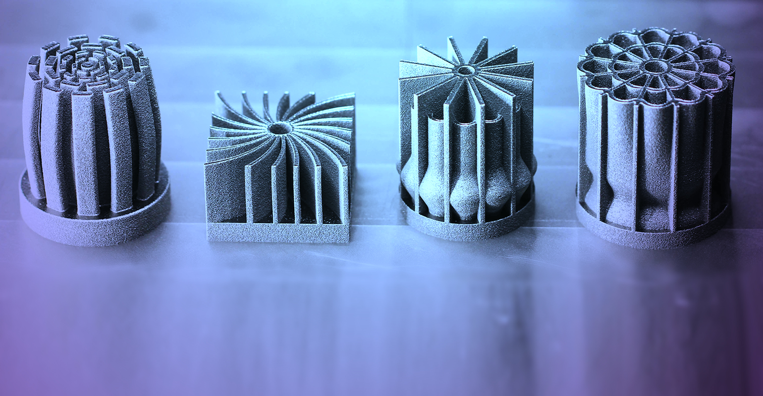

Aluminum heat sinks
3D Metal Printing: Tips, Trends, and Common Misconceptions
