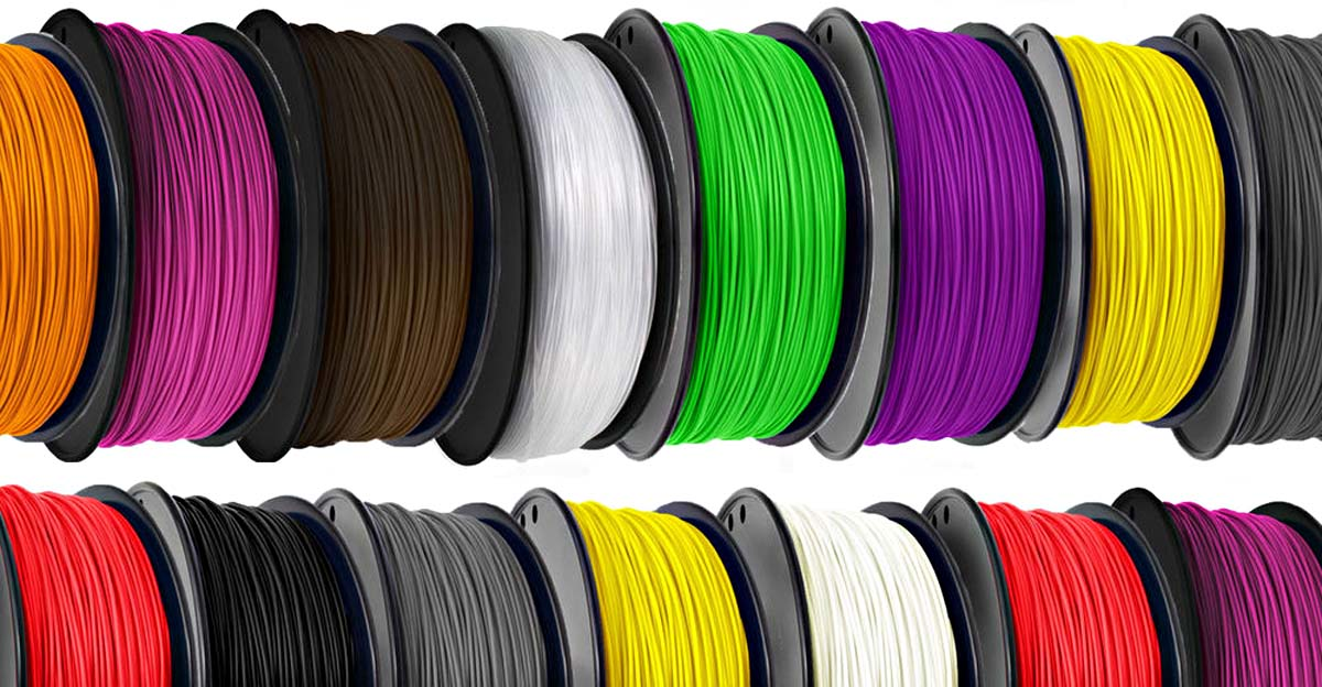

It’s inevitable: Unless you only 3D print single objects, sooner or later you are likely going to have to connect several printed pieces together. Bonding those materials together is an easy endeavor and has many benefits, the most obvious of which being the ability to create objects that are larger than the print bed of most desktop machines—such as this StarCraft Battlecruiser designed by Sam Fenimore or this massive piece of artwork from ProjectEgg. While there are many different materials used in 3D printing, in this guide, we will focus on the most commonly used filaments found in the thermoplastic family: ABS, PLA, Nylon, and PETG.
Regardless of object size, it’s good practice to know which methods of bonding can be employed using thermoplastic resin and how to avoid the pitfalls associated with using the wrong approach (including deformation and, in some cases, “burning” the material). Nobody wants to waste both time and money by damaging your projects. With that in mind, below are several methods of bonding designed to connect thermoplastic objects together.
