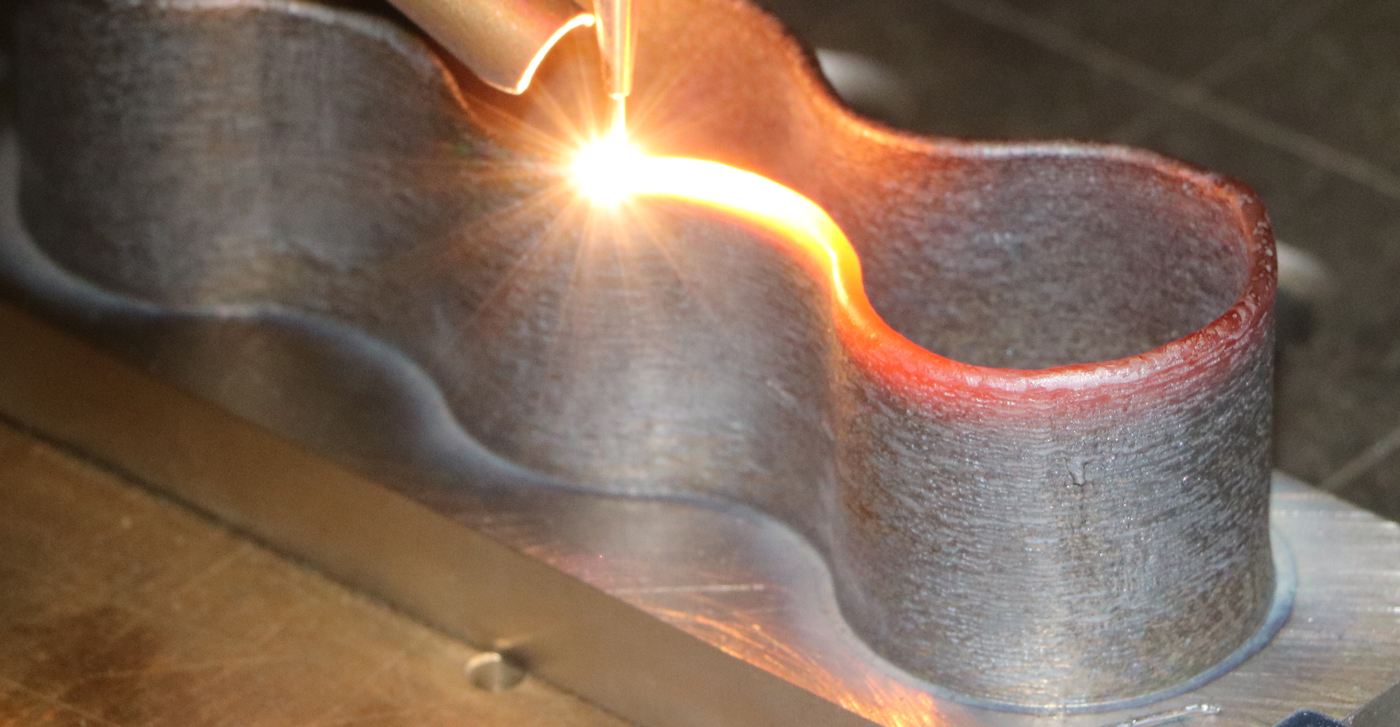

Powder-bed and deposition technologies vary greatly in terms of printing speed. Deposition can be over 125X faster than powder bed. Powder bed’s aim is to achieve fine surface texture; thus, it requires a slider to carefully and slowly bring out a new layer every 10 to 25 microns, leaving it at a slow speed of around 0.08 lbs per hour.
On the other hand, deposition is a process that lays down material with large beads reaching 10-mm-plus in width and 2-mm-plus in height. Rates of over 10 pounds per hour or more are very achievable. 3D Hybrid Solutions is working on high-speed deposition that, we believe, could catapult that rate up to 10X faster.

The most common questions customers ask about AM processes concern the material properties. Generally, when raw, they're between a casting and a forging. Post-processing can bring them to heat-treated AMS and ASTM standards. But, the secret weapon of deposition-style technology is the ability to have control over the material properties throughout the build. You can even switch materials to place stronger materials in areas of high stress and lighter materials in areas of lower stress.
AM with wire: Internal features can be milled while the part is being printed, as the machine can switch from additive to subtractive and back as easily as switching tools. (Source: Laserline Gmbh, Germany)
Deposition-style printing is giving us the ultimate freedom, switching metals on command. With deposition-style printing, designers can go back to the drawing board and redesign with almost no limitation, specifying gradient material properties and different materials in different areas.
