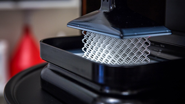

3D printing start-up Carbon (formerly Carbon3D) was recently in the spotlight when it launched its first commercial offerings: a printer, dubbed the M1, and a range of resins for it targeted at prototyping and low-volume manufacturing applications. The M1 uses Carbon’s photopolymer printing process called “continuous liquid interface production” (Clip). It builds parts in a vat of photopolymer resin by shining UV light up through a window in the bottom to expose an entire layer of the part being printed at one time. The company claims its process is up to 100 times faster than other photopolymer printing processes like stereolithography (SLA) and photopolymer inkjet, and also results in materials with anisotropic mechanical properties.

The core advantages of the Carbon system are its speed and ability to build parts without the material layers characteristic of traditional 3D printed parts. The bonds between traditional layers greatly weaken printer parts, reducing their usefulness.
In 2013, Lux Researched called out mechanical performance and build speed as critical issues for 3D printing. So, had Carbon’s M1 come out in 2013, it would have been incredibly disruptive. However, major progress has been made in part strength and print speed in the past three years by groups such as Oak Ridge National Laboratory, Cosine Additive, and Arevo.
Carbon’s published mechanical performance figures, while good, are not disruptive or even best in class. In addition, the M1’s build chamber is relatively high, but quite narrow. This likely indicates that there is difficulty in rapidly flowing viscous resin under the part as printing occurs, which limits the possible size of the build chamber. A wider build chamber would make it much easier to penetrate the tooling market, the second largest and rapidly growing segment for 3D printing.
