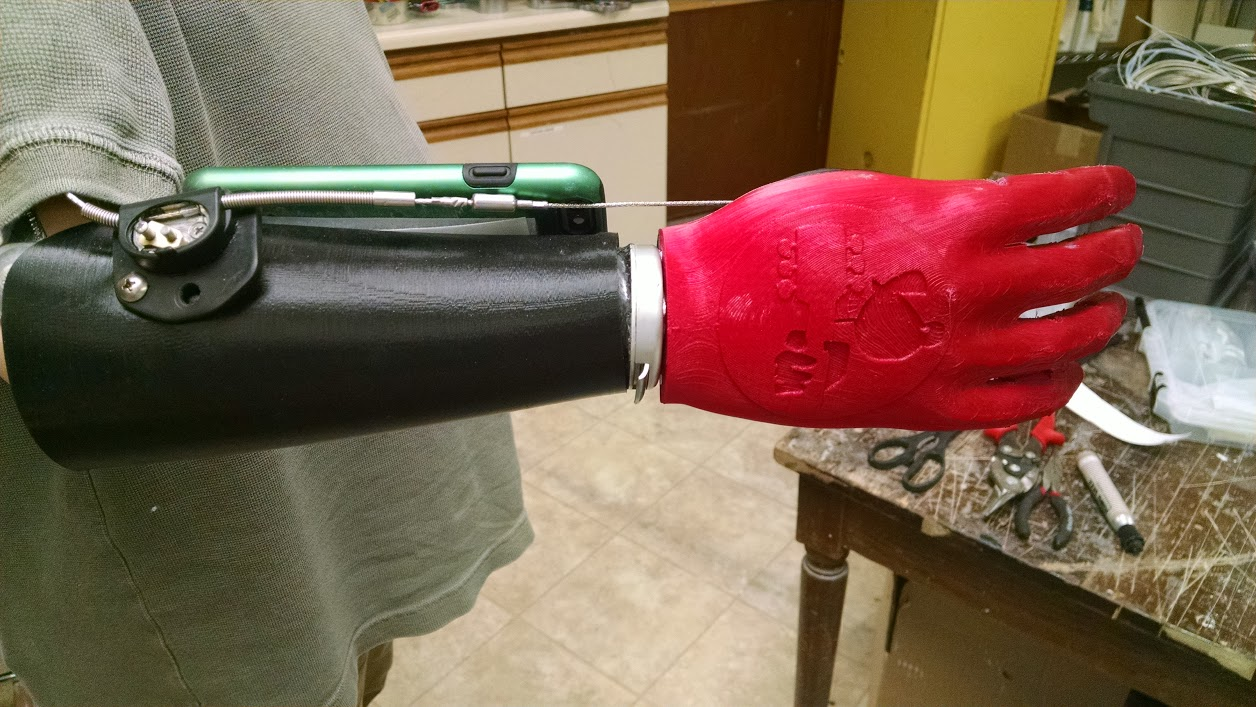

I have found that most 3D-printed designs have overlooked socket design. Frequently, the amputee interface is a uniform half-shell shape with a Velcro strap. Holding positions on e-Nable’s advisory board, I tell designers to focus on the socket more than spending their time working on the terminal device, which is that hand portion of the prosthetic arm. With that said, there are some things that an experience prosthetist can learn from the makers of these 3D printed devices. From these makers I have learned that:

A suggestion I have for a person working on print prostheses is to focus more attention on the sockets. The conventional method for making a socket is to take a cast or digital scan of the patient’s residual limb. Then, modify contours of this model to apply pressures on the soft tissue, and relieve pressure from sensitive areas (i.e., bony prominences, fragile skin, and sensitive nerves (Of course, this description is just an overview. The specific details are complex, and more information can be found here).
One way to make a better-fitting socket is to use flexible materials in this interface like most conventional prostheses do. I am familiar with rigid printable materials like PLA, ABS, and nylon. However, I would not build a socket out of any of these. At Create Prosthetic, we design almost exclusively with flexible material called Flexy Fit.Thermal plastic elastomers (TPUs), such as, Ninjaflex, Filaflex, etc., work well, too. These materials are all urethane-based materials, which are a common material for prosthetic liners and flexible inner sockets. Flexible materials can help dissipate forces on the prosthetic over a larger surface area of the residual limb, making it more comfortable to wear regularly and for longer periods of time.
There are some designers of 3D-printed prosthetics who are already using flexible materials in their designs. Steve Wood of Gyrobot and I designed a partial hand prosthesis made from Filaflex. Open Bionics Arm uses Ninjaflex and Semiflex in its arms, and Life Prints arms use Filaflex in their devices.
